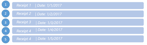

Lets suppose that I am posting 5 inventory receipts on a sequential order in different dates (January, February, March …etc). The image below illustrates how purchase receipts are posted in terms of order and dates.

As shown above, all the receipts have the same unit cost, which results in the same unit cost and adjusted unit cost (both are 20). Now, if I enter another receipts proceeding to all the dates above (for instance, 1/6/2017), the average cost will be calculated as follows:
