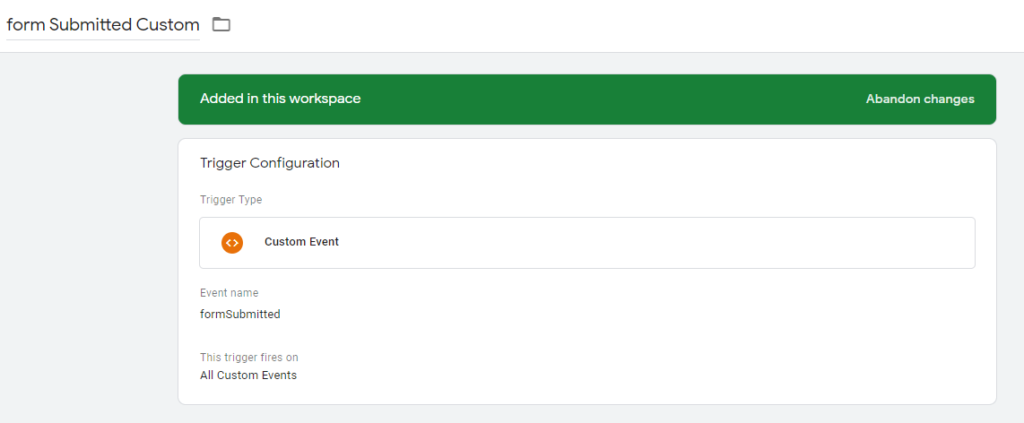

Next, we are going to add another Trigger this time one that will run when formSubmitted is past through as information from a webpage. This should all be clear in a moment. Add a new Trigger with the Trigger Type of Custom Event. Add in the Event name of formSubmitted. Then give the Trigger a name that is logical, such as form Submitted Custom.
