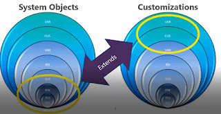

Layers:
Layers are the traditional AX concept but in D365, there is a new process where we extend layers as shown below.
Also when you create your model, you specify which layer the model is going to live in. However the importance of layer is quite minimal for instance, you are not required to provide a key for your model to live in that layer. Previously layers were single stack of code that over-layered upon each other. This new process uses layers but they are located in independent stacks.
