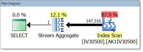

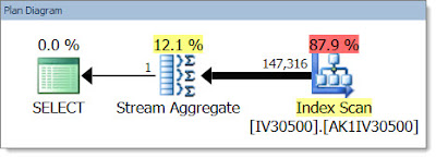

Apparently when ANSI PADDING is off for a field, when it needs to evaluate the field for a query, it must sometimes pad spaces on the end of every single row value before it can perform a comparison. As a result it must scan every row in the table, or in an index, before it can fulfill the query.
This is what I was seeing with the MAX function on the TRXSORCE field of IV30500. Every single record was being returned by the Index Scan.
The TOP 1 operator apparently does not have to perform this same padding operation, so it is able to simply retrieve one row from the index and return it.
This is a pretty big deal.
While I'm guessing that MIN and MAX aren't widely used in Dynamics GP queries, there are certainly some situations where they would be useful. If they are used on a table with a large number of rows, the performance hit will be significant.
In some cases, using TOP 1 may help, but as the key sentence above states, even the TOP operator may trigger the same performance issue in some queries.
If you are using MIN, MAX, or TOP and see an Index Scan in your execution plan that returns every row in the table, that may be a sign that you are encountering this issue.
