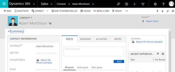

How to Set the Entity Image on a Contact in Dynamics 365 Using C#
When trying to set an entity image for a contact programmatically it may seem logical that you would set it using the base64 string of an image just like you would set the ‘documentbody’ field in an annotation, but this is not the case for entity image. When deciding on an entity image for the contact it is recommended by Microsoft to use a 144x144.png for best results. Other viable dimensions are: 60x80, 144x400, 400x500, 400x144 which is all noted in Microsoft’s documentation here.
