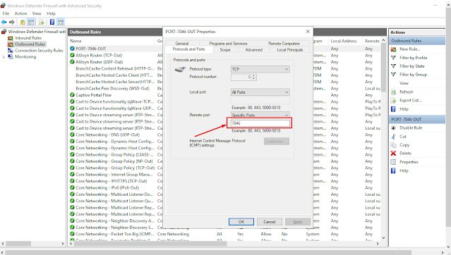

If you're unable to PS-Ping the correct IP with Port number, simply check the Advanced Firewall Setting  in Inbound and Outbound Rules.

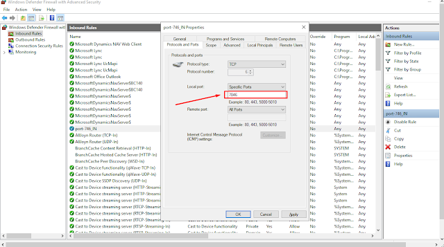

Inside Windows:
Inbound Port 7046
Inbound Rules - Port 7046
Outbound Port 7046
Outbound Rules - Port 7046

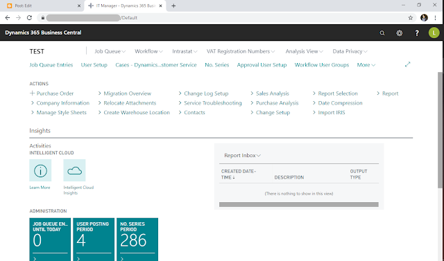

Simply login into your Browser with the Web Client URL
Business Central - Web Client

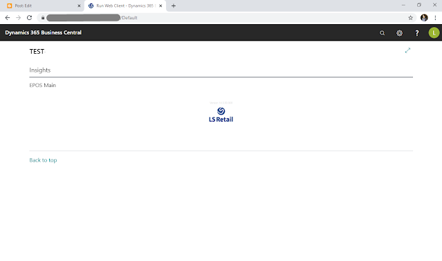

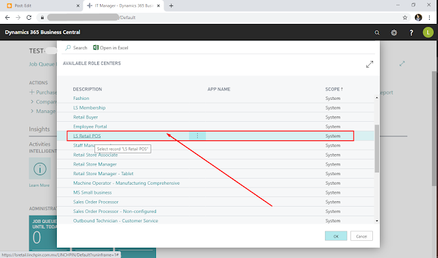

Select the LS Retail Role
Once, you have selected the correct Role, automatically your Business Central session will refresh and will initiate LS Retail Web-POS

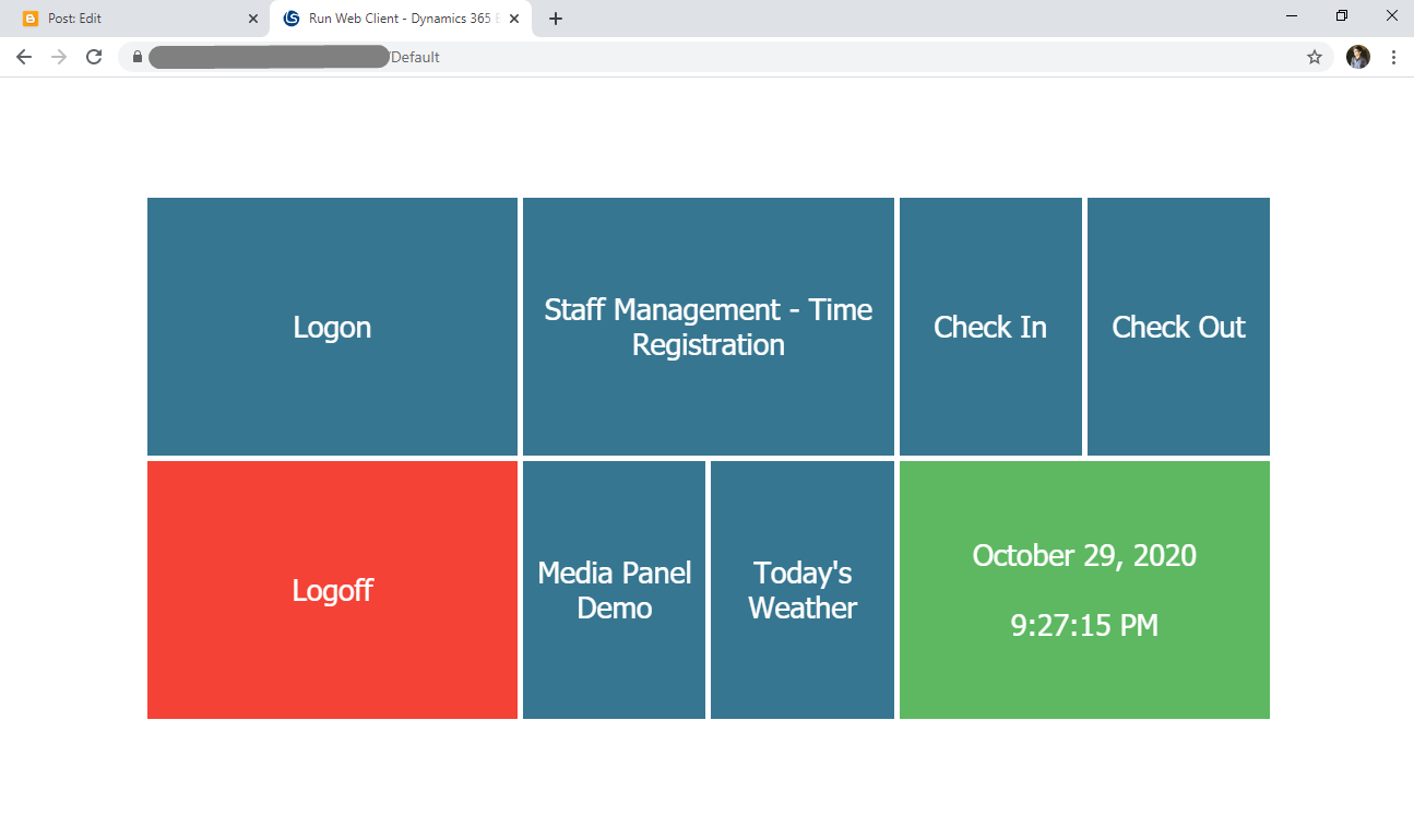

LS Retail - Web POS Initializing
LS Retail - Web POS - Login Screen

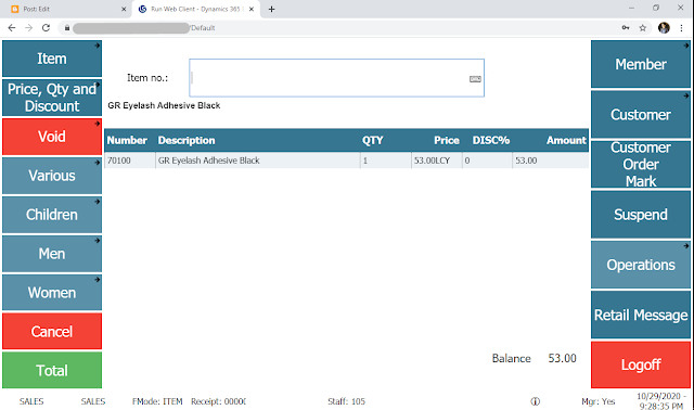

LS Retail - Web POS - Transactions
