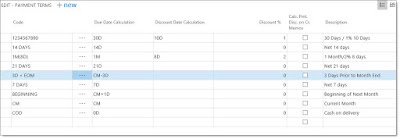

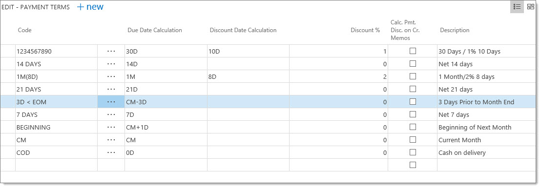

At first glance, the Payment Terms window looks really basic. Code, Due Date code, Discount Date code, Discount Percent, and Description. Very simple and standard looking.
But notice the column headers: "Due Date Calculation" and "Discount Date Calculation"
Instead of just having "30D" for 30 Days, there are codes you can use to setup some unusual payment terms.
Let's say you need to pay 3 days before the end of each month. You would use a Due Date Calculation of CM-3D. CM means Current Month, and -3D means subtract 3 days. So CM-3D means 3 days before the end of the current month.
CM+1D apparently means the beginning of the next month.
10D means 10 days from today, while D10 means the 10th day of the month.

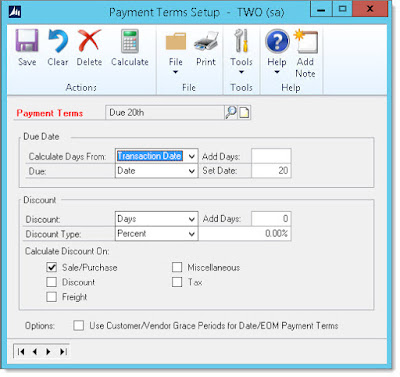

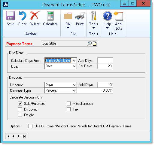

So how does this compare to Dynamics GP payment terms? It looks like the current GP Payment Terms window is fairly good, but is different.
GP seems to have a few more options, such as calculating due date based on Transaction Date or Discount Date, and having a separate configuration for Discounts. Very few (maybe one?) of the customers I have worked with actually use terms discounts, but for customers that take advantage of discounts, this may be valuable. I'm pretty sure most of the customers I have worked with just ignore vendor terms and pay Net 60, Net 90, or Net 120 for cash flow purposes.
Dynamics GP also has options to calculate the discount on Sale/Purchase, Discount, Freight, Misc and Tax, which I am not seeing in D365.
