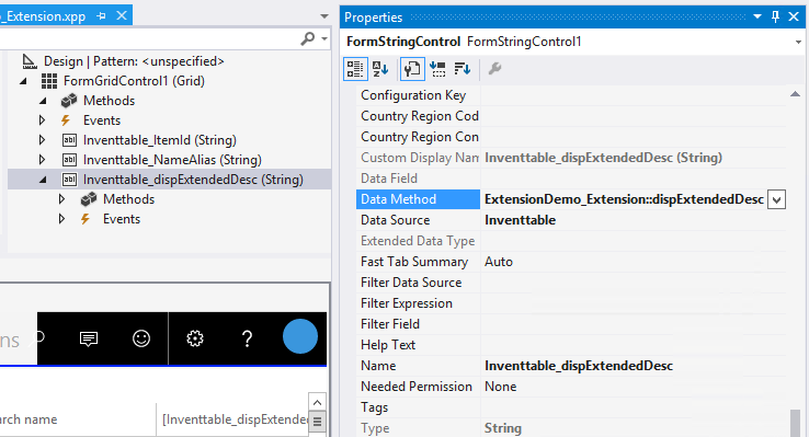

Creating table methods is pretty the same, you can even create new display and edit methods as shown below, to be used in a form (or form extension) in the same model :
[ExtensionOf(tableStr(InventTable))]
final class ExtensionDemo_Extension
private void new()
[SysClientCacheDataMethodAttribute(true)]
public display Description dispExtendedDesc()
return this.Description5+this.Description6;
To be able to use this display method in your form, you need to define the “Data method” property of your data field like this, using static method operator and name of your extension class (“ExtensionDemo_Extension::dispExtendedDesc”). Directly writing the method name will not work :

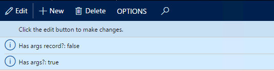

You can add a simple click method and test our extension method inside the form :
public void clicked()
super();
info(strFmt("Has args?: %1", element.parmHasArgs()));
info(strFmt("Has args record?: %1", element.hasArgsRecord()));
