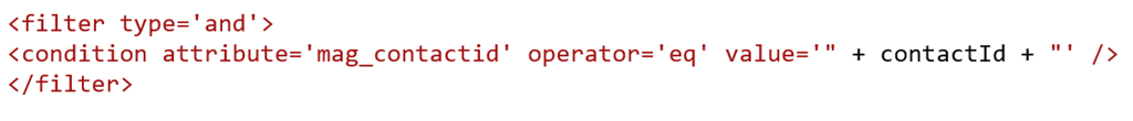

How to Use AddCustomFilter
This will add your filter to the filtering already applied to your default look up view, so if you’re going to use this you should ensure you either know you default filters or have them blank so you don’t get any surprises in your results.
The parameters of this method are:
• Filter criteria this does not contain the whole fetchXML definition. Instead it is only the filtering criteria.
• The entity that the view will look up to.
Example Fetch:
