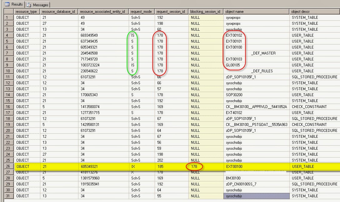

When she sent me the results of the query, it painted a great picture of the problem. Here is a screen shot of the query results--I know it looks busy, but stay with me, it's pretty simple to interpret.
Notice that the highlighted row is the only one with a value in the "blocking" column. That means that an application is trying to perform an operation on the EXT00100 table, but is being blocked by another process. Notice that the "request_mode" column on that row says "IX". This means that the row in yellow is waiting for an "exclusive" lock on the table, in this case because it is trying to update the EXT00100 table.
When a SQL process is blocked, it typically causes the calling application to wait--it will often just sit there and be completely unresponsive as it waits for the SQL command to finish. The SQL operation usually finishes in a fraction of a second, but if the process is blocked, it may wait for a minute, or perhaps indefinitely, until the operation completes.
The Dynamics GP consultant knew that particular yellow row was a Dynamics GP user--the user reported that GP was locked up. So this told us that something was locking the EXT00100 table, and that is why Dynamics GP was locking up--it was waiting indefinitely for the table to become available for an update.
Which leads us to the records for process 178. 178 is the process that is blocking the update to EXT00100. But why is it blocking? Well, if you look at the "request_mode" values, most have a value of "S", which means "shared lock". Shared locks allow other processes to read the locked data, but the data cannot be changed or updated while the shared lock is present. So process 178 appears to have issued SELECT queries against the EXT tables, with the default shared lock, that are preventing Dynamics GP from updating those tables.
Fundamentally, this isn't a problem--a query can retrieve data from the EXT tables, complete in a fraction of a second, and then the shared lock is released. But for some reason, the shared lock of process 178 persisted for up to 20 minutes at a time. During that time, Dynamics GP would become unresponsive if a user tried to update any Extender records.

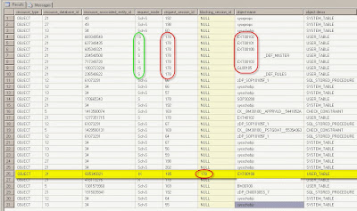

http://technet.microsoft.com/en-us/library/aa213039(v=sql.80).aspx
Steve Endow is a Dynamics GP Certified Trainer and Dynamics GP Certified IT Professional in Los Angeles. He is also the owner of Precipio Services, which provides Dynamics GP integrations, customizations, and automation solutions.
