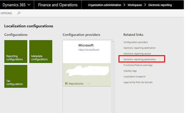

Go to Organization administration -> work spaces -> Electronic reporting
Then click on "Electronic reporting parameters" (I'm using 8.0 version with PL 22)

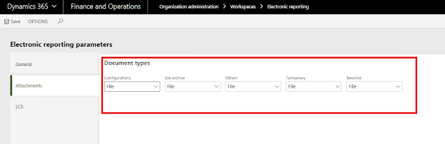

Update "Documents types" in the attachments as shown below.
That's it.
That's it.
