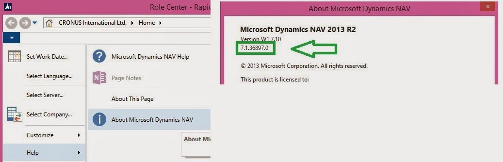

How Check Windows Client / RTC Client Build ?
1. Open Windows Client.
2. Navigate to Help, About Microsoft Dynamics NAV. The Screen will be like as shown below.
3. The Third Line (i.e Version) tells us the Client Build. In Picture above Windows Client Build is 36897 (7.1.36897.0)

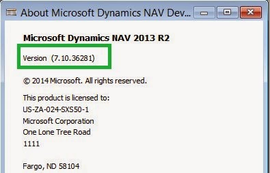

How Check Developer Environment Build ?
1. Open Navision Developer Environment on server / Client.
2. Navigate to Help, About Microsoft Dynamics NAV Developer Environment.The Screen will be like as shown below.
3. The Second Line (i.e Version) tells us the Developer Build.In Picture above Developer Environment Build is 36281 (7.10.36281)
