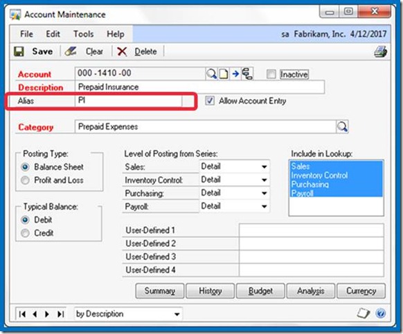

    Account Aliasing
    Creating an account Alias allows you to speed data entry by creating a Nickname for an account. Instead of having to remember or search for a specific account number. To create an alias, simply add the nickname to the alias field just under the Description field.
    clip_image002
    To use the Alias during account entry, select the expansion arrow next to the Account Look up Button or use CTRL Q on the keyboard to open the Account Entry window. Enter the Alias in the Account entry window, and the corresponding account will automatically come into the transaction.

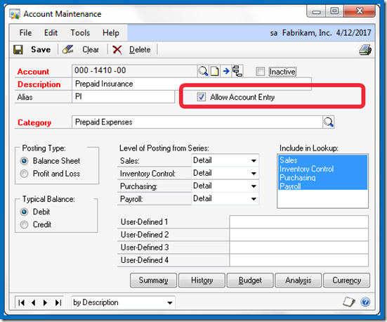

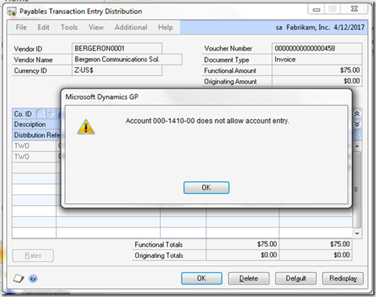

    Allow Account Entry Check box
    Using this check box can help keep your control accounts in balance with the general ledger. The default setting is checked thereby allowing this account to be selected if it has not defaulted in to a transaction. Therefore, you could make a journal entry directly to the cash account which most likely will create a problem during bank reconciliation. For all of your control accounts – those accounts updated by a subsidiary module – the Allow Account Entry check box should be cleared.
    clip_image005
    Once the check box is cleared, an attempt to use it will result in a warning dialog and the entry will not be allowed.

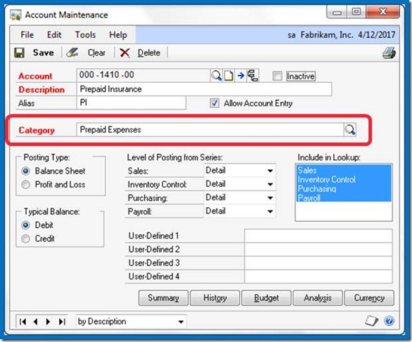

    Account Category
    This is a required field on the window and is used exclusively by the Advanced Financial Analysis module.
    clip_image008

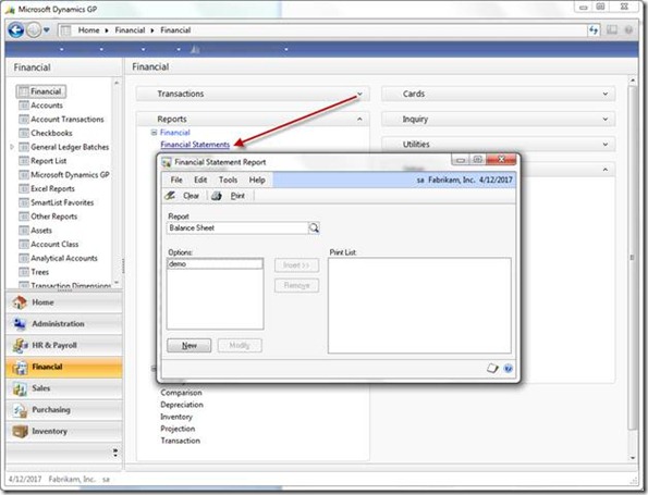

    The category assigned to an account determines where the account will appear on the financial statements printed from the Financial Area Page.
    clip_image010

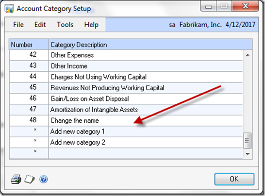

    The accounting system would run perfectly even if every account were assigned to the Cash category. Neither FRx nor Management Reporter relies on this setting to determine classification on the financials. Account Category reports CAN be used in financial reporting, and, you can create as many categories as you would like. In addition to creating new categories you can modify the descriptions of the default categories.
    Add categories or modify category descriptions on the Account Category Setup window.
    Financial > Setup > Category

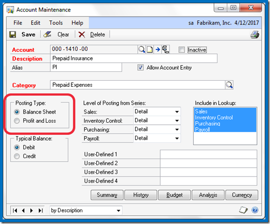

    Posting Type
    The posting type determines which accounts are rolled into Retained Earnings during the financial year end close. This setting affects nothing else. As part of your year end close checklist be sure to check each account’s posting type. If you have a beginning balance in an income or expense account after year end close, then the posting type is incorrect. KB article 864913 provides detailed instructions on how to recover from this type of problem.

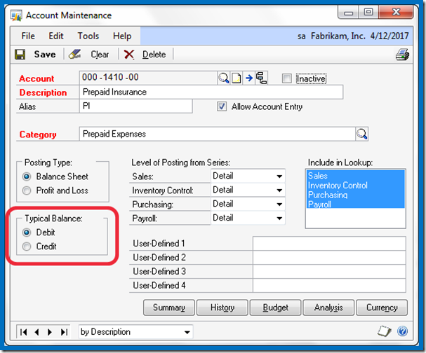

    Typical Balance
    This setting determines whether the account appears as a positive or negative number on the financial statements. The title is a bit misleading because even though the ‘typical’ balance of the accumulated depreciation account is a credit, the correct setting for purposes of the Account Maintenance window is Debit. Since accumulated depreciation functions as a reduction to an asset account, marking debit causes it to appear negative on the balance sheet. These settings were designed for the Advanced Financial Analysis module, and also control in which column (debit or credit) the cursor defaults during transaction entry.
    In short, the following are the correct selections for this section regardless of the typical balance from an accounting point of view:
    Account Type Typical Balance
    Asset Debit
    Liability Credit
    Equity Credit
    Income Credit\
    Expense Debit
    clip_image013

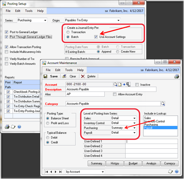

    Level of Posting from Series
    This setting works in concert with the ‘Create a Journal Entry Per’ option in the Posting Setup window. With ‘Batch’ selected and the ‘Use Account Settings’ check box marked, the system looks to the Account Maintenance window in order to know how to create the journal entry coming up from the subsidiary module.
    clip_image015
    Using the Payables Transaction Entry window as an example, the settings illustrated above would result in a single summarized entry to the Accounts Payable (000-2100-00) account per batch. Whether entries to the other accounts are made in detail or in summary would likewise be controlled by the settings on those individual accounts.
    For example, suppose only the Accounts Payable account was set to ‘Summary’ and our batch contained three vouchers. Each voucher contained a debit to the Prepaid Insurance account and a credit to Accounts Payable.
    The resulting entry posted to the GL for this batch would be as follows:
    Dr. Prepaid Insurance 56.98 Dr. Prepaid Insurance 27.50 Dr. Prepaid Insurance 15.00 Cr. Accounts Payable 99.48

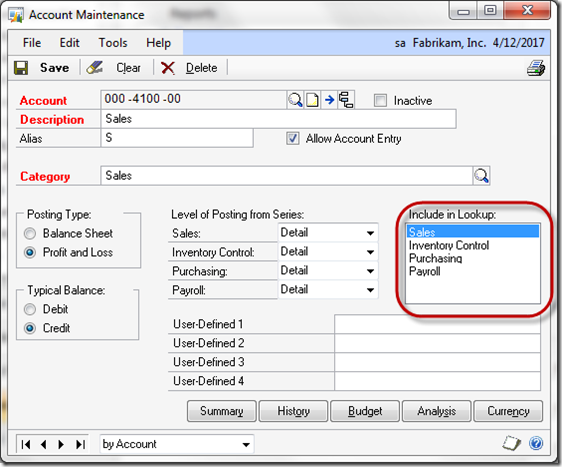

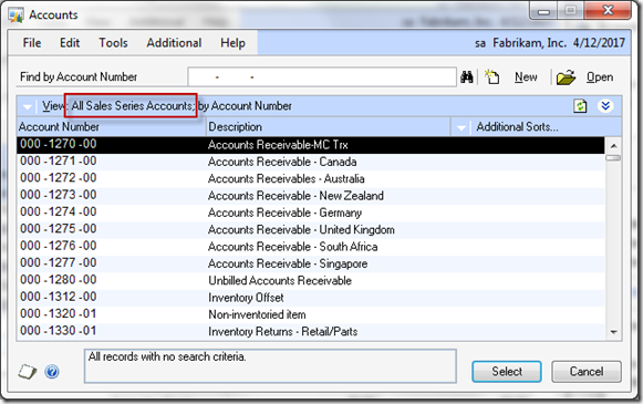

    Include in Look up
    If all of your accounts are listed whenever you click on the account look up button, then you haven’t made use of this powerful setting. The default setting marks all of the items (Sales, Inventory Control, Purchasing, and Payroll) and is rarely changed. To illustrate this setting, I’ve taken away the ‘Sales’ setting from all of the accounts except for the accounts I want to appear when I first hit the account look up button. Likewise, I’ve only included ‘Sales’ in the ‘Include in Lookup’ selection for my Sales accounts.
    clip_image016
    Now that my sales related accounts are marked to be included in the sales look up, my account look up window starts with Accounts Receivable instead of Cash.
    clip_image017

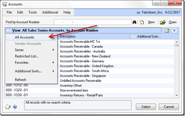

    The other accounts are readily available by clicking on the View menu and selecting All Accounts.

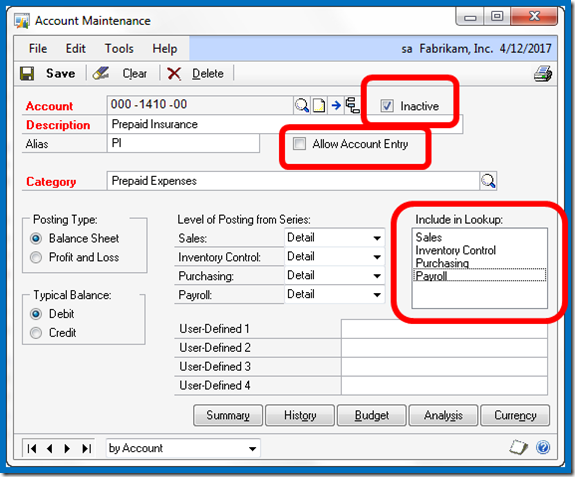

    Inactivate that Account for good!
    · Inactive – dah, enough said · Allow Account Entry – uncheck this box · Include in Look up – unmark all items
    clip_image019
