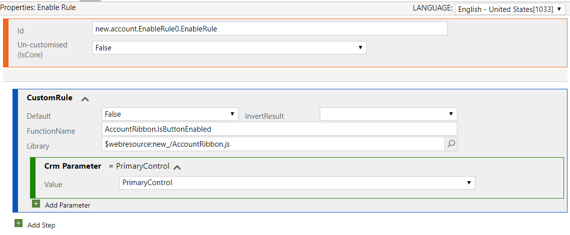

  • a33ik Profile Picture
    84,331 Most Valuable Professional on at
    Can you please provide screenshot of your button configuration? Like following:
  • Verified answer
    Victor Onyebuchi Profile Picture
    410 on at
    I have got this to work, i repostion the parater on in the ribbon workbench and it worked. Funny how just the position of a parameter can stop javascript from working.
