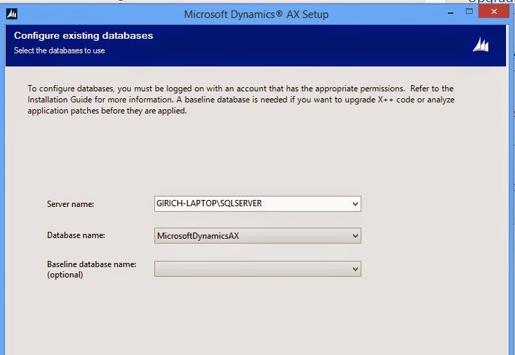

    Step-6. Start the AX 2012 R3 installation setup on a new environment as below,
    Step-7. Select only the databases component.
    Step-8. Select configure existing databases (Which is of R2 CU7 inside SSMS)
     Step-9. In this step, Assign the R2 database (MicrosoftDynamicsAX of R2 CU7) and make sure that the Baseline database name field is left blank during this procedure.
    Step-10. On the Select additional models page, select the Foundation model, Foundation Upgrade model, and any other models that you require for your deployment. Select the Foundation Labels model only if you are using country/region-specific features.
    After this step, the system creates a new baseline database which contains upgraded AX 2012 R3 models in the SYS, GLS, FPK, and SLN layers and Non-upgraded customer models in the ISV, VAR, CUS, and USR layers.
    Step-11. Now install all other required AX components.
    Step-12. Now, assign the database and upgraded baseline database in this step.
    QUERY-1:  Are these 2 DBs in below snapshot, MicrosoftDynamicsAX116 & MicrosoftDynamicsAX116_UpgradeR3Baseline  that we would be selecting in this step generated after Step-10 above ?
    Step-13. Once, the installation is completed then compile the whole application using the command “axbuild xppcompileall” from the command prompt. This compiled the whole application for me in just 30 to 40 minutes.
    Step-14. Now restart AOS and proceed with the code upgrade & data upgrade checklists. Follow the code upgrade document on the complete details.
    There is one QUERY-1 and NOTE-1 above in RED, if you can confirm on both.

    Tommy Skaue Profile Picture
    Microsoft Employee on at
    Regarding your first note. I also always prepare the copy of R2 on the Test server, ensuring it starts, compiles, builds, works, etc. And when I am ready to start, I uninstall all R2 components, even R2 Setup (using Control Panel, Programs and Features).
    There are several other steps you need to ensure with the copy.
    On your query, you ask a question that is already answered in the upgrade guide:
    technet.microsoft.com/.../jj733502.aspx
    Search for the statement "The Baseline database name field should be left blank during this procedure". It only occurs once in that guide, and is exactly where I believe you are unsure what to select.
    You say you have "MicrosoftDynamicsAX , MicrosoftDynamicsAX_model , MicrosoftDynamicsAXBaseline ( of R2 CU7 )". Out of those three databases, the only database you need to keep are the two first. The baseline database (third) has no value here. I never have a baseline database for production either. It is only of value in certain development scenarios. If you are not sure what the role of the baseline database is, have a look at this blog post I made back in 2013: yetanotherdynamicsaxblog.blogspot.no/.../baseline-is-new-old.html
