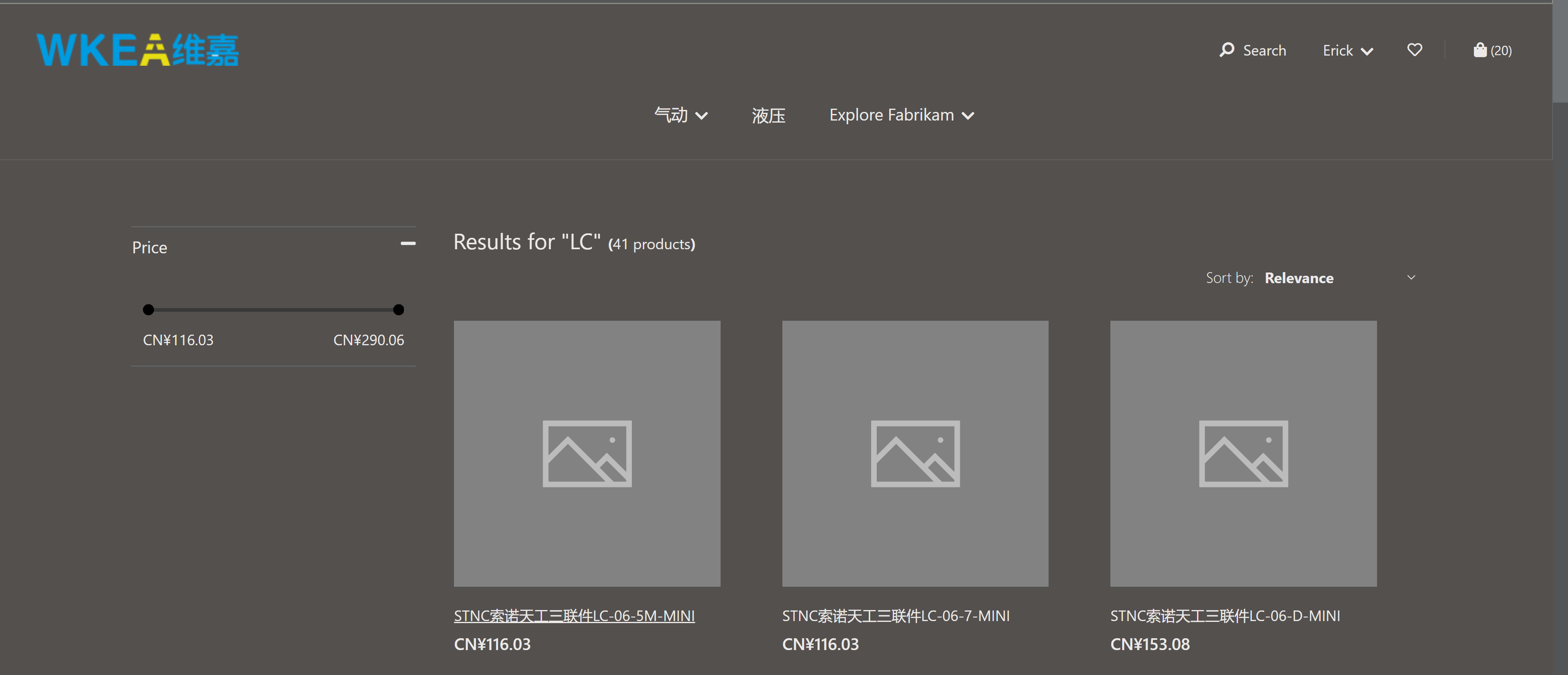

Posted on by 50

    Hi Ashish,
    Thanks very much for your confirmation!
    I've tested my scenario as below
    1. We have the products assorted in the product hierarchy, as below
    Then I run job 'process assortment', and after that I run '1040' and '1150' jobs, after their status be 'applied' i go back to the e-c web site, and the issue still continues.
    Please help confirm if I missed any step, much appreciate for your help!

  • Erick Li Profile Picture
    50 on at
    Hi Ashish,
    Much thanks for the detailed guidance, I did at a wrong 'full sync' in the first try.
    Now I followed your detailed steps and I am sure there is no "Excluded" products in the assortments.
    I have again do online store update publish, and do full sync for jobs 1040, 1070 and 1150, after all these jobs status be applied, I go back to e-c web site, and the issue not resolved.
    The related products detail page still show 404 error.
    our Dynamics 365 version is 10.0.12
    and the RSCU build number is 9.22.20282.7 (10.0.12)
