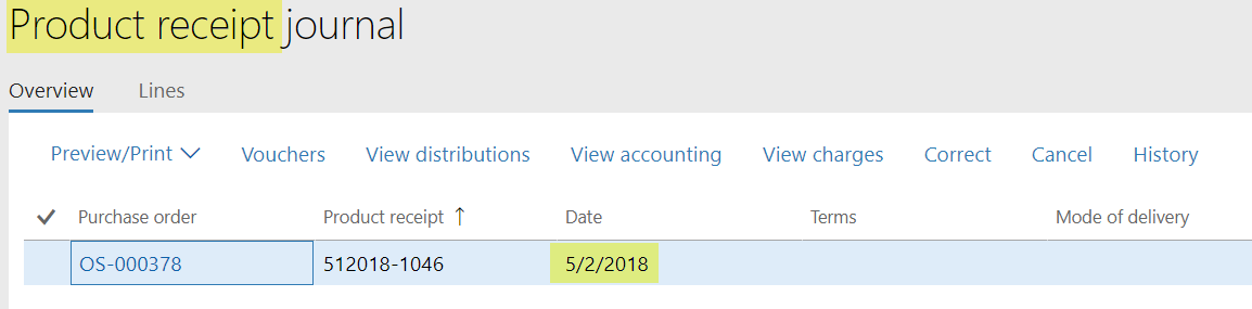

I realized that the Product receipt date drives Inventory Aging.  I posted the product receipt today.  Run the Inventory Aging today and it shows the inventory is 1-day old which is correct.  In reality, I have the ownership of this inventory last month.  So I want to use the Ownership date to drive inventory aging date.  The problem is, the last month's accounting is closed.  I don't want to post the actual product receipt date into last month's book.  This is due to sea shipment which takes months to get to US.  I only want to drive the inventory aging date.  Have you seen a situation like this?  If so, how did you solve the problem?  Thanks

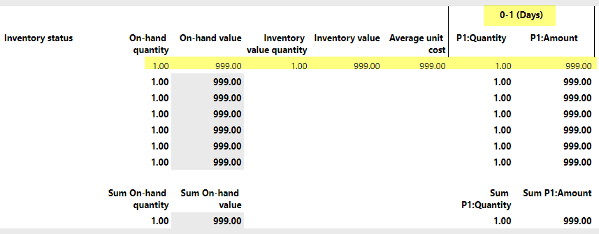

Now it sits in my Inventory Aging report as 1 day old:
