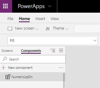

1. Create a new component
Click on New Component under the Components tab to create your component. Rename the default name to NumericUpDn.
| Components tab |

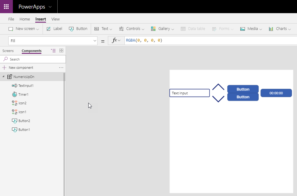

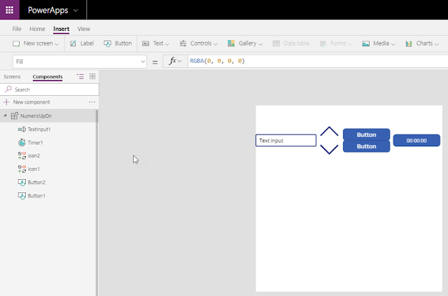

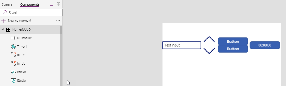

2. Add the controls needed to create this component.
- 2 button controls (from the toolbar)
- The Up icon (from the Icon gallery)
- The Down icon (from the Icons gallery)
- A Timer control (from the Controls gallery)
- A Text Input control (from the Text gallery)
I always recommend you worry about the layout and aesthetics at the very end of the implementation. Nonetheless, I keep the controls close for ease of organization at the end of the implementation.
| Controls |
The most important thing right now is to get the needed controls. I will also explain the use of each control as we go along.

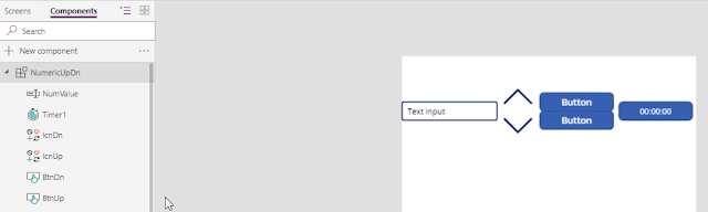

4. Rename the Controls
Now that we have all the controls and custom properties in place, we will begin by renaming the controls for readability sake and ease of following - it's also a good practice.
Button1, rename to BtnUp
Button2, rename to BtnDn
Icon1, rename to IcnUp
Icon2, rename to IcnDn
TextInput1, rename to NumValue
| Rename component controls |

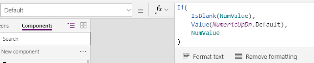

NumValue control: for this control, change the Format to Number. We will want to ensure the text input control Default property is set to the incoming Default custom property value if the initial value is blank, as follows:

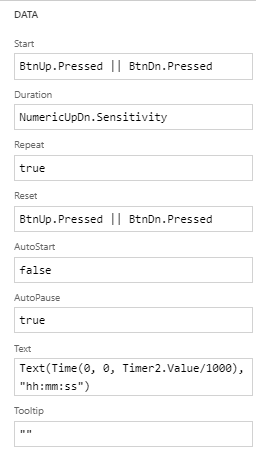

Timer1 control: this is perhaps the most important control on the component, since it will basically control the overall behavior of the timer. First, let's set some properties:
- Start property. We will want to start the timer when either the BtnUp or BtnDn pressed events are fired. Since the Start property is a true/false control (boolean) we can set the property to BtnUp.Pressed || BtnDn.Pressed.
- Duration property. We will set this property to NumericUpDn.Sensitivity. Basically, we are setting a delay between each increment or decrement of the NumValue control.
- Repeat property. Set to true. Since we want to persist the button press event, we want the timer to restart each time after the Duration cycle is completed.
- Reset property. We need the Timer to reset each time either button is released from a Pressed state. Hence, we can use the same true/false state as the Start property, BtnUp.Pressed || BtnDn.Pressed.

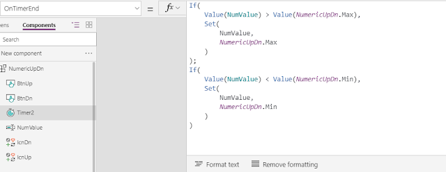

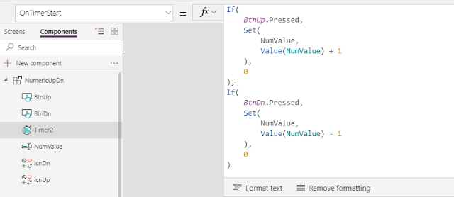

Next, the timer must perform a couple actions: 1) on start, it will evaluate which button was pressed, and based on the button, increase or decrease the value in the text control. 2) on end, it will evaluate whether we've reached the lower or upper limits established by the Min and Max custom properties, respectively.
For the OnTimerStart event,
| OnTimerStart |
| OnTimerEnd event |

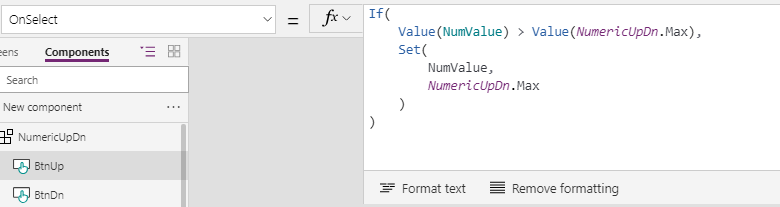

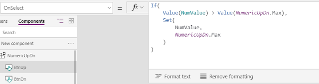

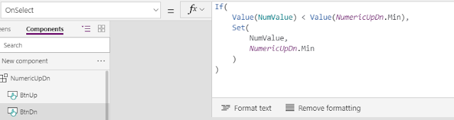

BtnUp and BtnDn controls: we also want a user to retain the ability to click the buttons without persisting the pressed event, effectively advancing the NumValue control one by one until the upper or lower limits are reached. Hence we must also add some validation to the OnSelect event of each button.
For the BtnUp OnSelect event,
| BtnUp OnSelect event |
For the BtnDn OnSelect event,
| BtnDn OnSelect event |

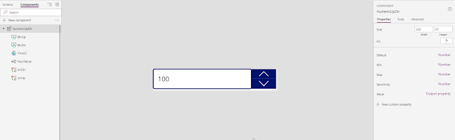

You should now have something that look like this:
| NumericUpDn component (shown at 150%) |

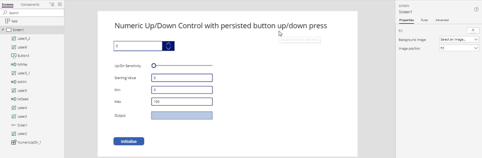

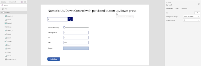

7. Testing the Component
To test the component, I have added the control from the Components gallery, a slider for the timer sensitivity, and a couple Text Input boxes, along with a label to track the output from the componentized control. You can quickly guess what goes to what.
NOTE: please ensure the Text Input boxes are of numeric type.
| Test Screen |
The end result can be appreciated in this video.
