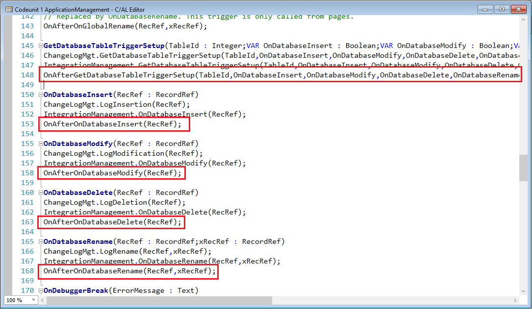

If you have been programming in Dynamics NAV for a while you are probably aware of the OnDatabase functions that runs when records are inserted, modified, deleted or renamed (they run just prior to the data being committed to the database). Those functions have in Dynamics NAV 2016 been extended with calls to new OnAfterOnDatabase functions (highlighted below).
OnDatabase-Triggers-Codeunit-1-Dynamics-NAV-2016

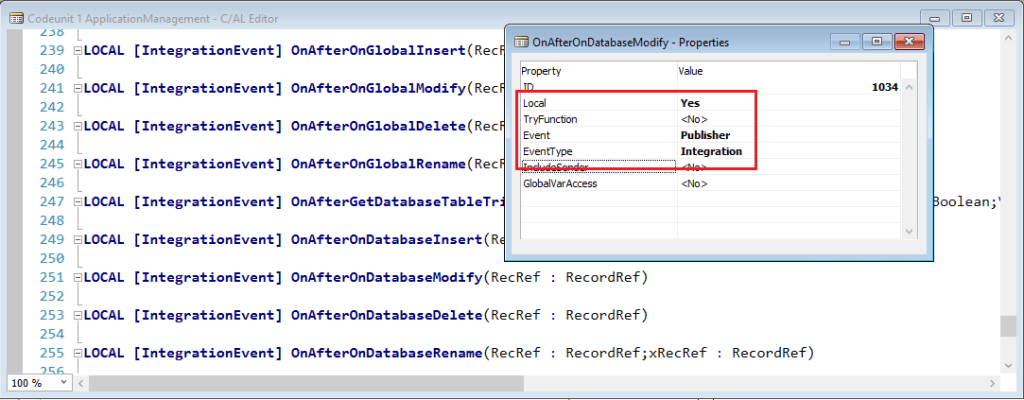

Those new functions are created with the property Event = Publisher and EventType = Integration. This means that the functions are published and can be subscribed to by other functions in the application.
OnAfterOnDatabaseModify-Codeunit-1-Dynamics-NAV-2016

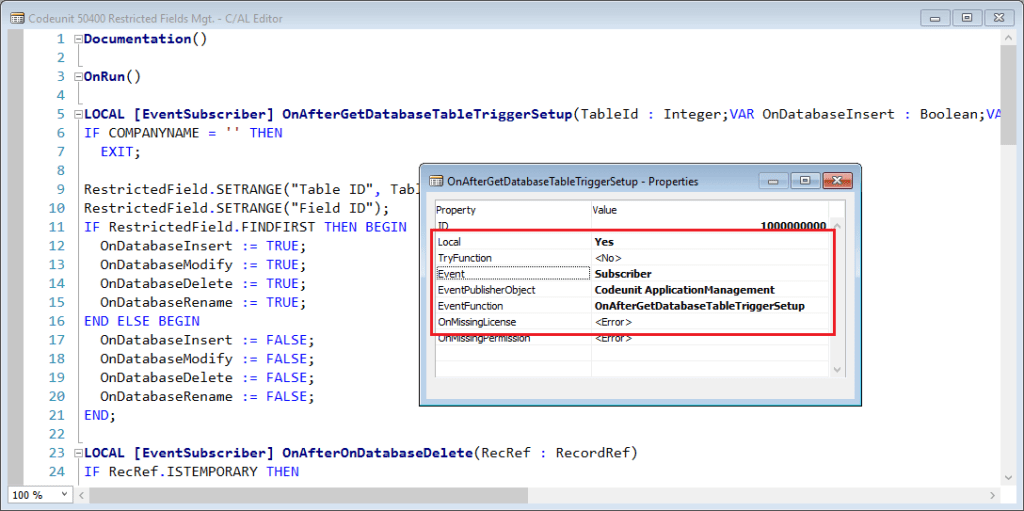

I my example I created a Restricted Fields Mgt. codeunit with the following functions; OnAfterGetDatabaseTableTriggerSetup, OnAfterOnDatabaseDelete, OnAfterOnDatabaseInsert, OnAfterOnDatabaseModify, OnAfterOnGlobalRename that are all subscribing to the corresponding functions in codeunit 1. The subscription is done by setting the Event property to Subscriber and in the EventPublisherObject property select the object (codeunit 1) and in the EventFunction select the published function to subscribe to.
Subscriber-Functions-New-Codeunit-Dynamics-NAV-2016

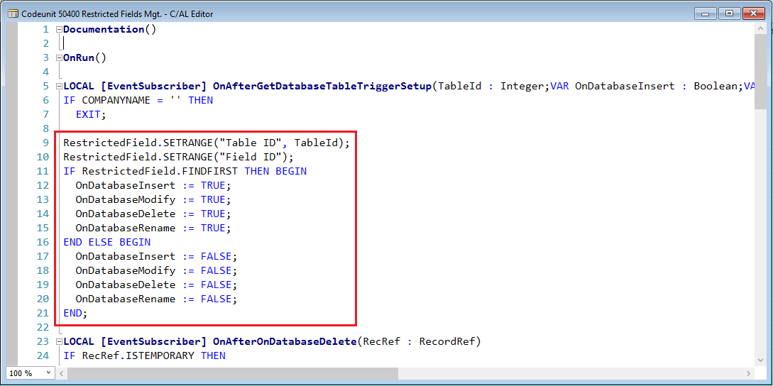

The code in the OnAfterGetDatabaseTableTriggerSetup function just returns true if the record that is being changes is in a table that have a restricted field. Returning true will make NAV call the OnAfterOnDatabase functions, otherwise those are not called (same concept as the change log again).
OnAfterGetDatabaseTableTriggerSetup-Restricted-Fields-Codeunit-Dynamics-NAV-2016

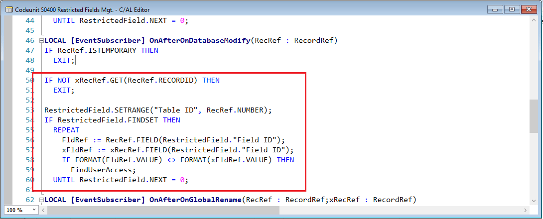

Then in the other functions we just compare the value of the restricted fields on the record being changed with the record that is in the database. We do this using RecordRef and FieldRef variables, the key here is that the record we get from the database is the ‘unmodified’ record that we can compare with, and we are only comparing the restricted fields.
OnAfterDatabaseModify-Restricted-Fields-Codeunit-Dynamics-NAV-2016
