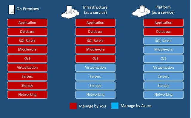

Comparison of On-Premises vs Azure as a Infrastructure vs Azure as a Platform.
As you see, when you select the last option (SQL as a Service) you move almost all the administration work to Azure. This will definitely help you to focus more on your business application and save money for your company and minimize the risk of maintaining everything by yourself.
