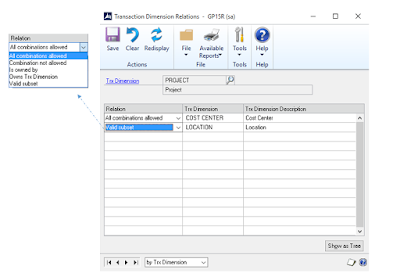

  3. In order to define the dimension relation, Go to (Cards > Financial > Analytical Accounting > Transaction Dimension Relation)
            Financial Dimension Relations
On this window, you pick the dimensions one by one and define the assignment rules for this specific dimension as related to other financial dimensions. The assignment rules are; as derived from the Dynamics GP Help File:
  • All combinations allowed: All code combinations between two transaction dimensions are permitted. For example, if the transaction dimensions profit center and cost center are set to a relationship of All Combinations Allowed then any profit center code can be used with any cost center code.
  • Combination not allowed: Code combinations between two transaction dimensions are not permitted. For example, transaction dimension profit center and cost center set to a Combination relationship is not allowed; then code combination between these transaction dimensions is not allowed.
    If you set the relationship between two alphanumeric transaction dimensions to Combination not allowed, you cannot use both the transaction dimensions at the same time for analysis during transaction entry.
  • Is owned by   Where the selected alphanumeric transaction dimension is owned by another alphanumeric transaction dimension. For example, cost center C1 is owned by profit center P1.
  • Owns Trx Dimension    where the selected alphanumeric transaction dimension owns another alphanumeric transaction dimension.
  • Valid Subset: certain code combinations between two transaction dimensions are permitted. This relation allows you to restrict the code combination
As for our case study mentioned at the beginning of this article, the relation of the three dimensions are as follows:
  • Project and Location: Valid Subset
  • Project and Cost Center: All combination allowed
  • Location and Cost Center: All combination allowed

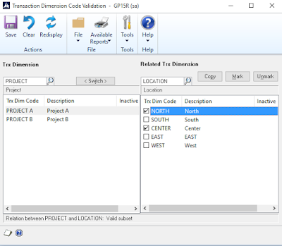

Now there is one missing point yet, which shall guide you on where and how to define the valid subset of dimension codes as illustrated in the initial graph. To do so, Go to (Cards > Financial > Analytical Accounting > Transaction Dimension Code Validation)
Follow the steps below:
  1. Choose the transaction dimension which has the valid subset relation on the left panel
  2. Choose the other transaction dimension included in this valid subset relation from the other panel on the right
  3. Choose a specific code from the left, and then check the codes to be assigned and allowed accordingly as shown below
Valid Subset - Restrictions
In summary, Analytical Accounting dimensions relations define the rules of how different financial dimensions shall relate and operate. Such configuration will restrict the user when distributing amounts on the predefined dimensions to allow or disallow specific dimension relation.
