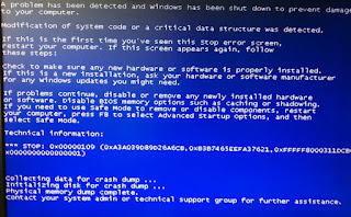

Sure enough, the blue screens showed up again a few days later, but unfortunately, the message displayed wasn't very helpful.
Sometimes you will get lucky and see a specific driver listed, like "ETRON_USB_3", which can tell you immediately that a third party USB 3 driver is causing the problem.
But in my case, since a specific driver wasn't listed on the blue screen, just a cryptic "STOP" error, I didn't have any clues as to a possible cause. I figured that my only option would be to try and reinstall Windows, which isn't on my favorite-things-to-do list. So I put it off and just ignored the occasional crash, knowing I would eventually have to deal with it.

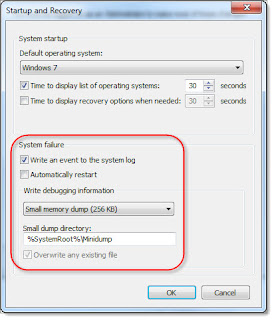

In the Startup and Recovery options in Windows, there is an option to "Write debugging information". In the latest versions of windows, the default setting is to write a "Small memory dump", also known as a "minidump".
When Windows encounters a "system error", it writes certain diagnostic information to this memory dump file explaining the specific area of the operating system that caused the crash and possible causes of the problem.
