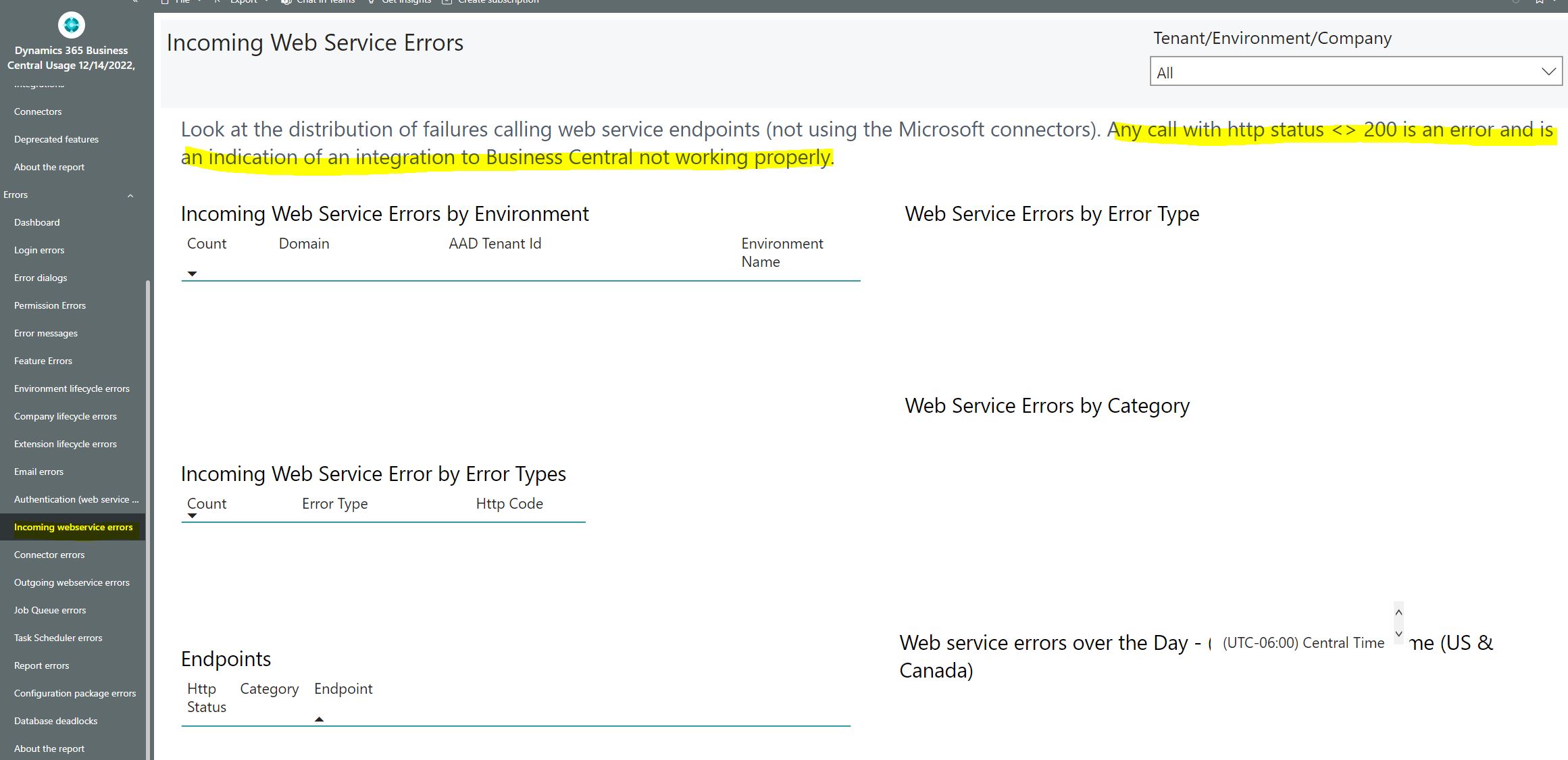

Example 3: Incoming or Outgoing web service errors
Any call with a http response status not equal to 200 is an indication of a web service failure:
For more information check the awesome documentation and the sample KQL on incoming web services error logs.
