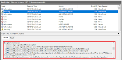

For better verification we will check first event log. It will  give us more details of this error.
See in below screen shot the event log is giving ExpiredCertificateException.

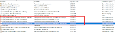

Further on we can check our certificates by going on this navigation : Search Certificates -> Local Computers ->Personal -> Certificate
Here you will find 4 expired certificates by checking there dates in expire column.

1. Find certificates by going on following navigation : Search in Windows Start Menu : Certificates -> Local Computers ->Personal -> Certificate. They all will be expired.
  • DeploymentsOnebox.DaxRunnerTokenUserCertificate.pfx
  • DeploymentsOnebox.LcsClientCertificate.pfx
  • DeploymentsOnebox.MRClientCertificate.pfx
  • DeploymentsOnebox.SessionAuthenticationCertificate.pfx
2. Identify thumbprint of each certificate. By double clicking on them. It will open a screen, from there select Details tab. Search thumbprint there and you will get key from there.
