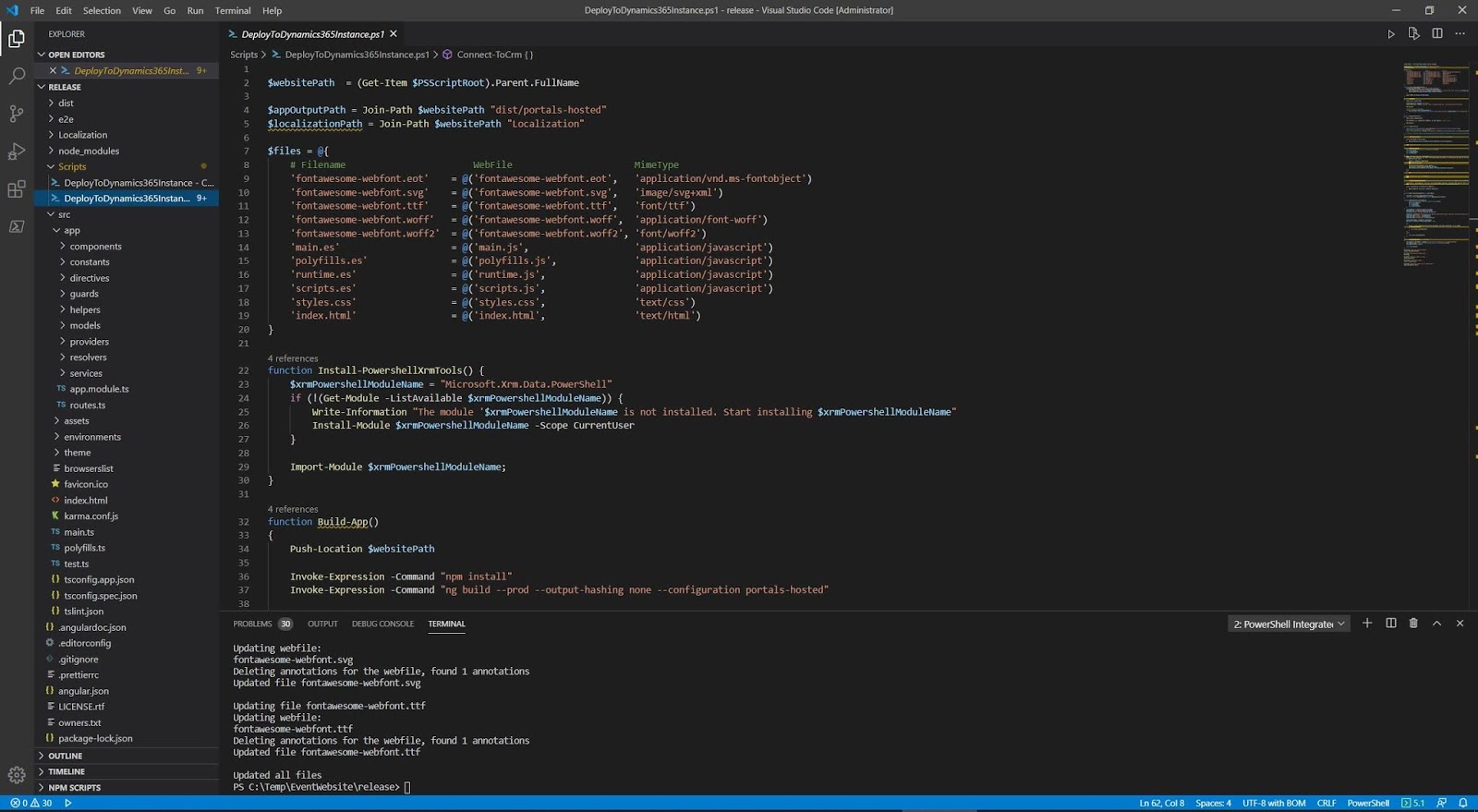

5. You can then open the project using Visual Studio for your convenience only by executing "code" command, see below
*I feel this is important otherwise you do not have one single UI to manage your files

Next is how do you deploy? You can deploy it manually or you can use the script, the script is in the folder already.
Script name: DeployToDynamics365Instance.ps1
Location: ..\EventWebsite\release\Scripts
(*your location may be different, but it is inside the Scripts)
Don't forget to change the connection string in the ps script or you can enable interactive mode
Find this keyword, you can comment or uncomment this part
#return Get-CrmConnection -InteractiveMode
