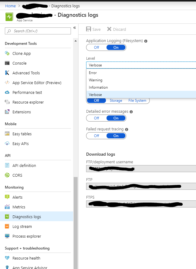

Now navigate to your Azure Account --> The app service where you have deployed the Web APP --> Diagnostics Logs.
You have something called "Application Logging (Filesystem)" and you can switch it on. There are four options available there.
Error - Error, Critical
Warning - Warning, Error, Critical
Information - Info, Warning, Error, Critical
Verbose - Trace, Debug, Info, Warning, Error, Critical (all categories)
I normally prefer Verbose as it gives everything.

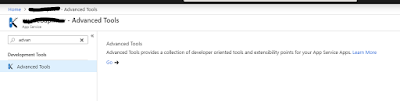

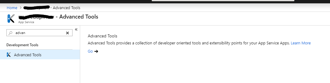

Navigate to Advance Tools under you AppService and Click on Go

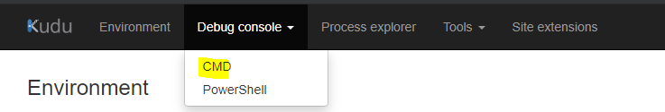

It opens a new tab as below - Click on Debug console and then CMD.

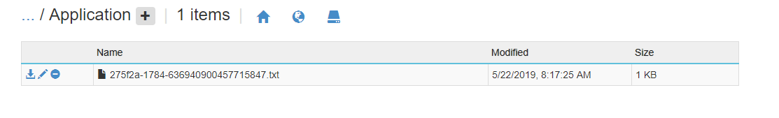

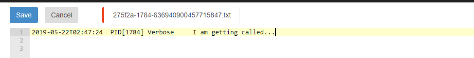

You will see the below screen, click on LogFiles --> Application, you will see the .txt file. Click on Edit icon to see the logs.
