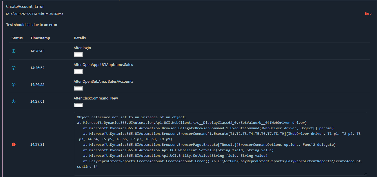

You can drill into each individual test so see what was logged, start/end times, and the duration.
Clicking on a screen shot that was included will display a full-size version. I've also chosen to format the exception details in a code block, so they stand out from the regular text.

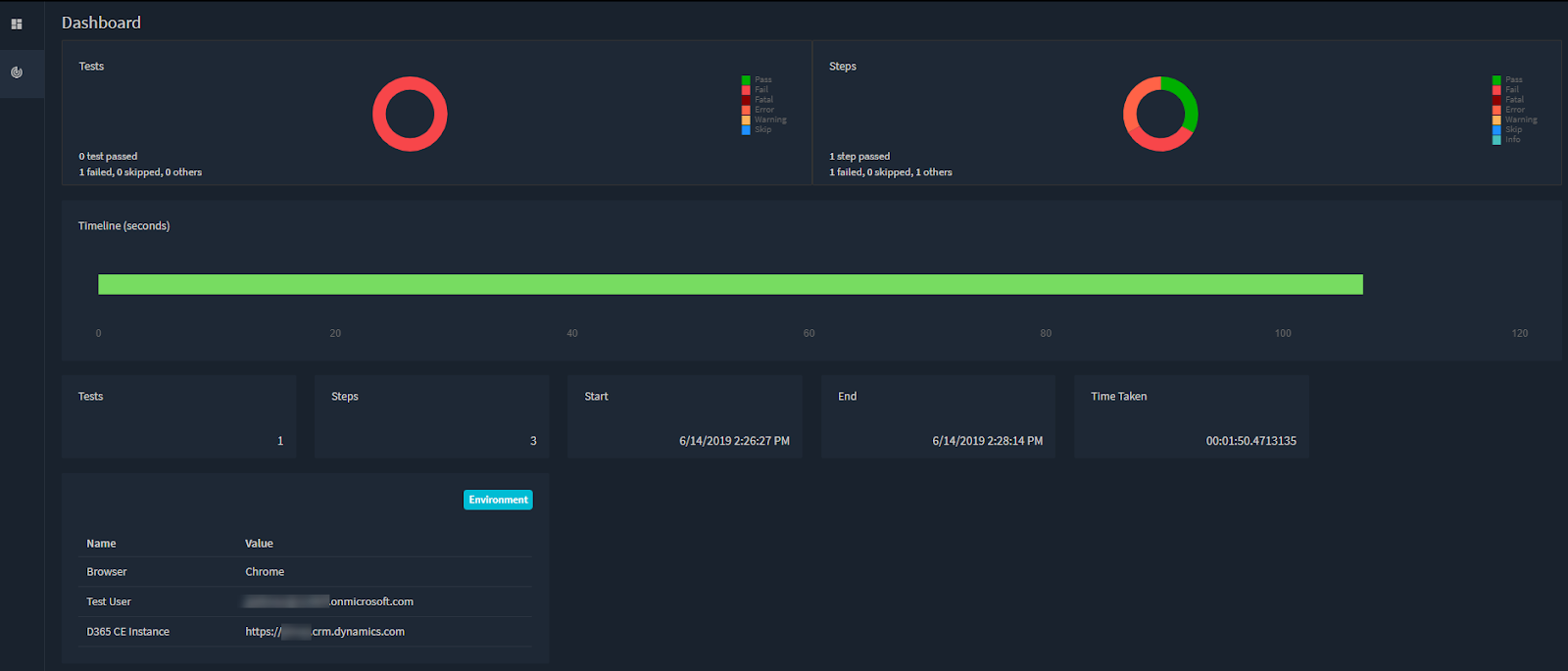

The report presents a nice looking dashboard which sums up detail about all the tests performed. In this example Tests reflects the number of unit test classes I included in the run and Steps shows the number of individual tests. If any of the steps fail, it reports the overall test has failed.You can drill into each individual test so see what was logged, start/end times, and the duration.
