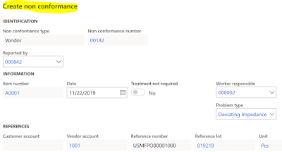

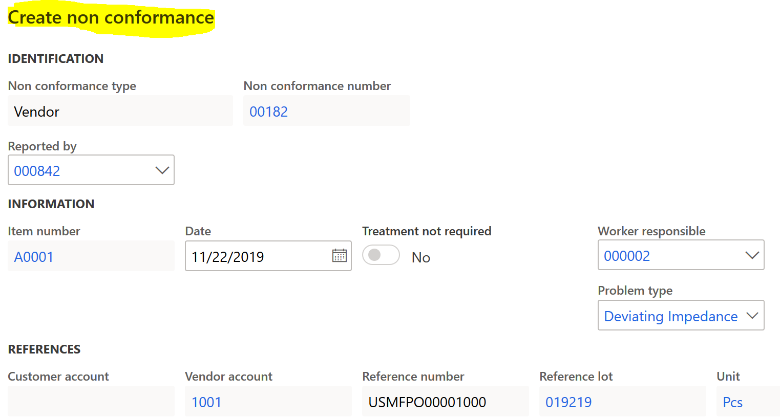

2. The QA tester will than create the Non Conformance for the Quality Order. The benefit of creating from a Quality Order is that it has all the necessary details (like Vendor, Purchase Order and Batch #).
Create Non conformance
