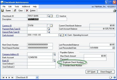

First, go Cards>Financial>Checkbook and select the checkbook from which the check was issued. If the Duplicate Check Numbers checkbox isn't checked, check it. Click Save. Leave the Checkbook Maintenance window open. We'll be coming back to it.

2. Go back to the Checkbook Maintenance window and uncheck Duplicate Check Numbers.
