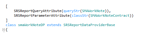

You need a query:
Use the query in the data provider:

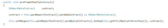

Filter the query in the controller. You must do it in the prePromptModifyContract method:

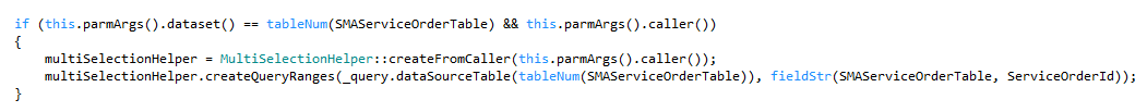

The piece of code from setRanges:
MultiSelectionHelper has some nice functionality. Just couple lines of code +1 for clearing the ranges before.
You pass a caller, a query data source and a field to filter on. That's it.

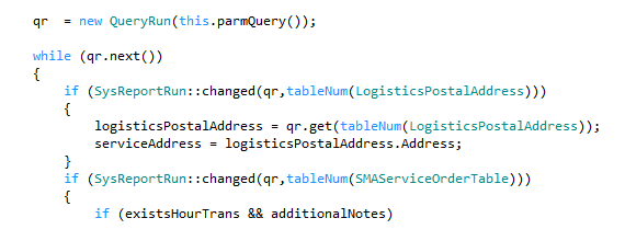

Then you need to traverse the query in the data provider. You know how to do it already.

You need a query:
