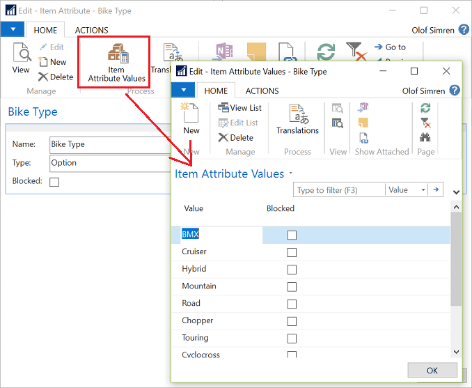

You basically setup your attributes that you want to use by specifying a name, type and unit of measure (the type controls what values you can enter).
item-attribute-dynamics-nav-2017
For the attributes where the type is option you specify the valid item attribute values (which then becomes a drop-down list when adding attributes to items).
item-attribute-values-dynamics-nav-2017
Note that attributes that are the option type does not have a unit of measure (for some reason the developer though that was not needed, not sure I completely agree).

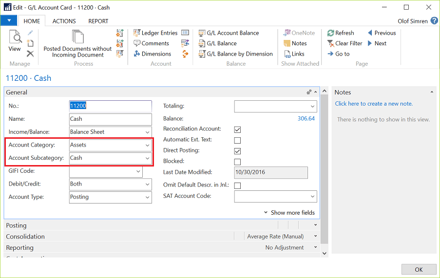

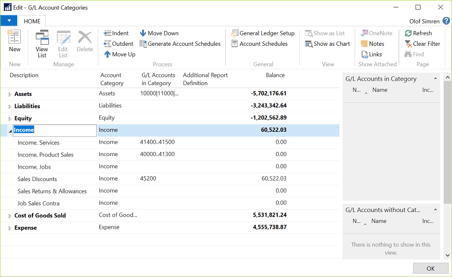

G/L Account Categories and Sub Categories
General ledger accounts can now be categorized. To do this there are two new fields on the general ledger account card; Account Category and Account Subcategory.
general-ledger-categories-dynamics-nav-2017
A fairly small addition, but very useful. Now you can group accounts that are used for similar postings, something like revenue accounts can be grouped into types product, service, shipping revenue accounts and this can then be used as filters when running reports.
You also have the option to view the total amounts by the different categories.
totals-by-general-ledger-categories-dynamics-nav-2017

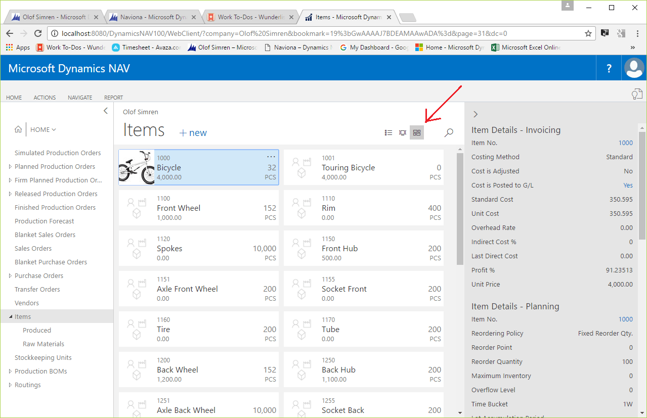

Brick View
List can now be viewed as bricks by changing it from a list to bricks using the below button, this is only for the web client.
brick-view-web-client-dynamics-nav-2017

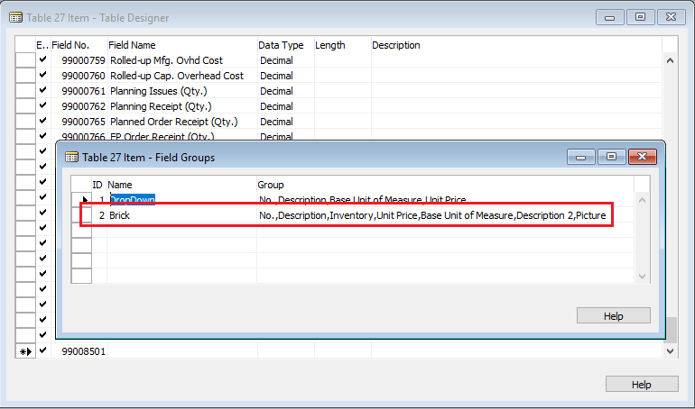

What’s displayed in the bricks are defined in the Field Groups on the table (same place where you define what fields that are displayed in drop downs), so you would need to change the table object to select what should be displayed. Would have been nice if it was part of the personalization instead actually.
brick-view-field-group-dynamics-nav-2017
I see these brick views more for touch screen devices, but let’s see, maybe it is something regular computer users will like as well. Time will tell…

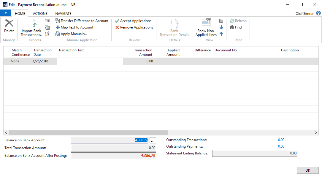

Improved Payment Reconciliation
A couple of minor improvements have been done to the payment reconciliation functionality in 2017. One of them is that it now shows the total amount in the payment reconciliation journal and you can drill into this amount and see transactions that’s have not been applied or reconciled.
payment-reconciliation-dynamics-nav-2017

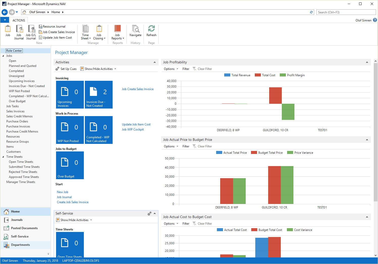

Improved Job Features
The 2017 job module has received a facelift (its always been a bit behind to be honest). There is now a project manager field on the job card and the project manage role center have been altered to show information specific to the jobs the user is managing. This should get the project managers going on the jobs that are not doing that well.
project-manage-role-center-dynamics-nav-2017

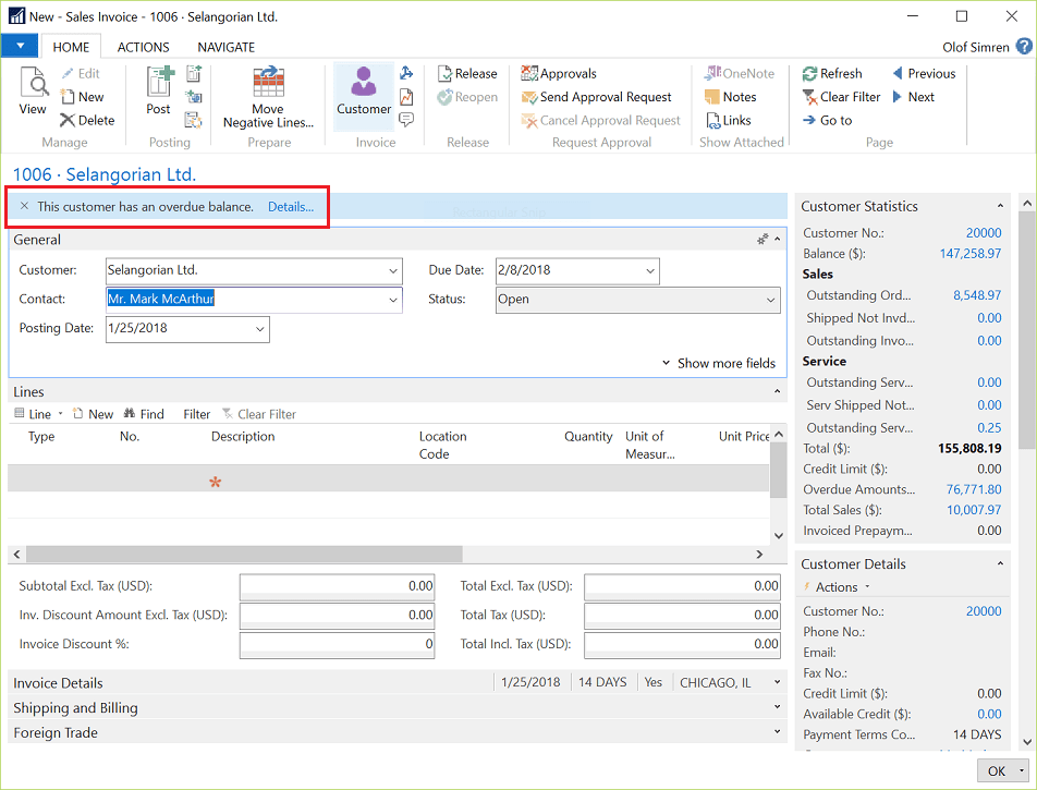

Smart Notifications
Partially built using the Notifications in the UI (which I will be describing more in a separate blog) the smart notifications gives you advice when you use the application. As an example; if you create a new sales invoice for a customer that have an overdue balance you will see the below notification.
notfication-on-sales-invoice-dynamics-nav-2017

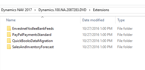

Extensions
Dynamics NAV 2017 comes with several extensions that can be deployed, I will not go into the details but there is a bank feed extension that allows you to setup a feed from your bank, some kind of PayPal integration, a QuickBooks data migration and a sales and inventory forecast solution (using Cortana intelligence I believe).
extensions-for-dynamics-nav-2017
All cool extensions, but what I would like to see is the localizations provided by extensions. That I think would be a huge leap forward. Everybody will then be on a W1 database and by using different extension you get the local functionality for your counties. And if there is a feature to turn on and off extensions by company then you can have a database for multiple countries. Maybe it’s just me that dreams about this.

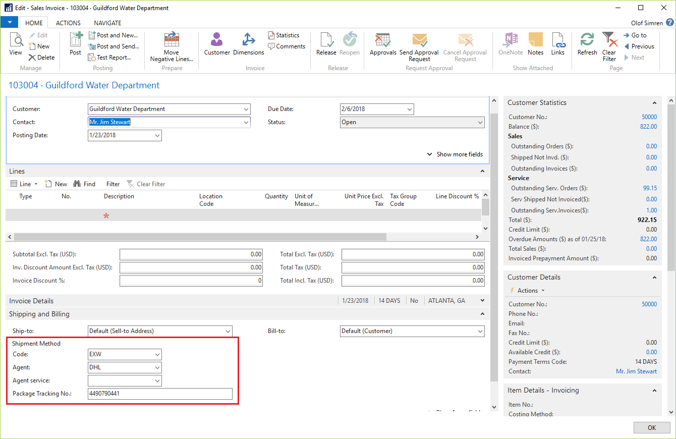

Package Tracking No. and Shipping Agent Code on Sales Invoices
The package tracking number and shipping agent code have been added to the posted sales invoices. Noting big, but kind of useful.

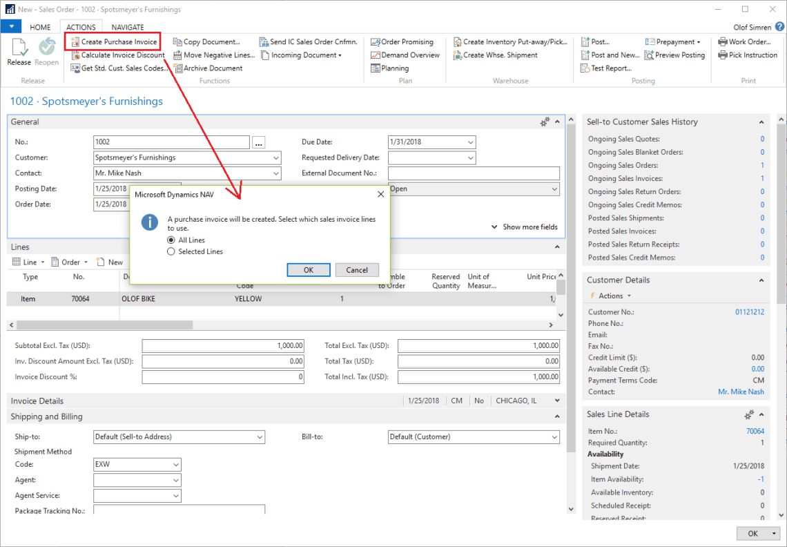

Create Purchase Invoice from Sales Order
There is a new function that allow you to create a purchase invoice based on a sales order. You select this and choose what items it should include through the below dialog, then you select a vendor and NAV will create the purchase invoice for you.
create-purchase-invoice-from-sales-order-dynamics-nav-2017

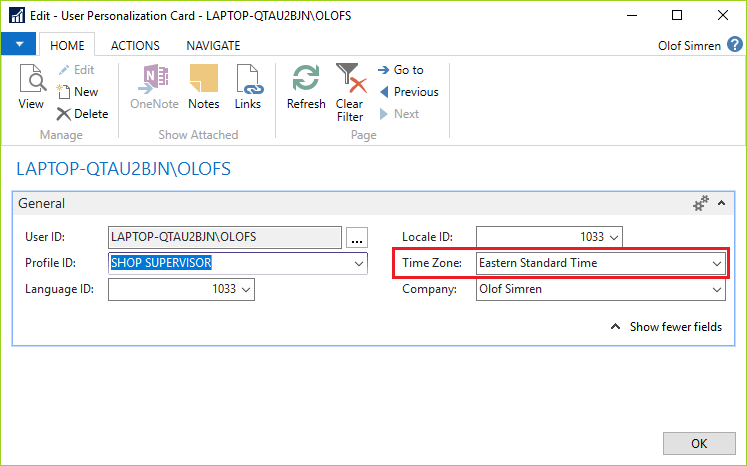

Time Zone in Users Personalization
The user personalization has been extended with a time zone field (not 100% sure where this apples and where the regional setting on you computer can’t be used to be honest).
user-time-zone-dynamics-nav-2017

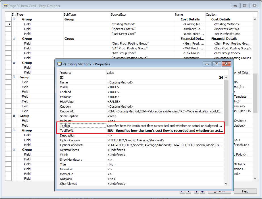

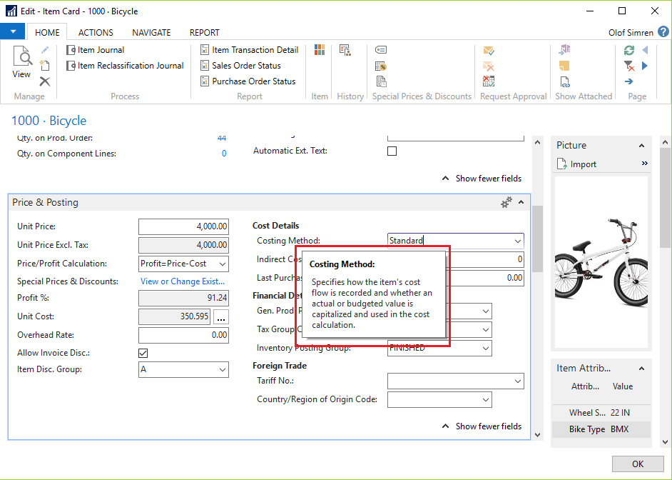

Tooltips have Been Populated
The ToolTip property that came with the previous version have now been populated on a lot of the fields (what a job that must have been  ).
tooltip-property-dynamics-nav-2017
This then shows up when you hover over the field or action item.
tool-tip-in-ui-dynamics-nav-2017

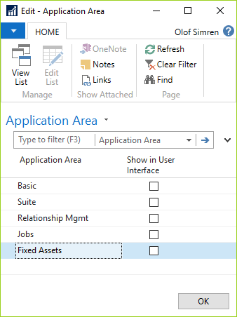

ApplicationArea Property
There is a new property in the development environment that can be used to define an application area for a page field, page part, page action, or MenuSuite item.
applicationarea-property-dynamics-nav-2017
This then works together with the application area setup which can be defined for a company, profile or user. It is not something that is mandatory to use, if you leave the setup blank then everything will be displayed.
application-area-dynamics-nav-2017
As with the new ToolTip property this is not something you can define on the table object, which I think is strange.

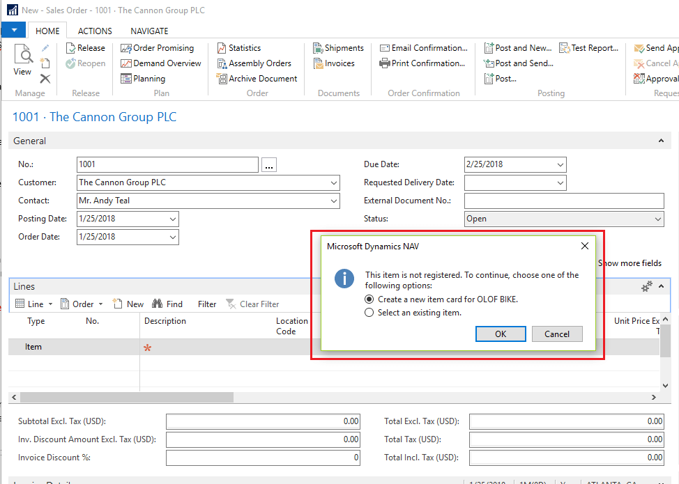

Create Item from Description in Sales & Receivables Setup
There is a new feature that can create an item for you automatically using the item templates when you enter a description in the no. field on a sales document that does not exists in the item list. Sounds nice and dangerous at the same time, doesn’t it?
You select Item as the Type, then you enter a description that does not exists in the item list in the no. field and tab out.
new-item-by-description-nav-dynamics-nav-2017
NAV will then display a dialog like below where you can select to have a new item being created using an item template, this will create the item and display the item card. When closing the item card that item number will be added to the sales line. So now the sale person can sell anything he/she likes!
create-item-from-description-2-dynamics-nav-2017

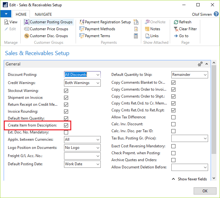

This feature can be activated/deactivated in the sale & receivables setup.
create-item-from-description-dynamics-nav-2017
