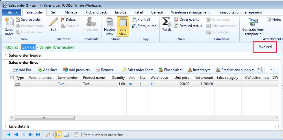

1. First step is to find invoiced sales order against which return order is getting created.
2. You can see above sales order which has quantity 1 which is already delivered to the customer and invoice is also generated for the same.
3. Sometimes due to incorrect items received or due to some defects in the item, customer want to return it to the company.
4. Before returning the items, we need to create a return order in AX for proper financial and inventory updation in the system.
Note: Sales order should be in invoiced state to create return order.

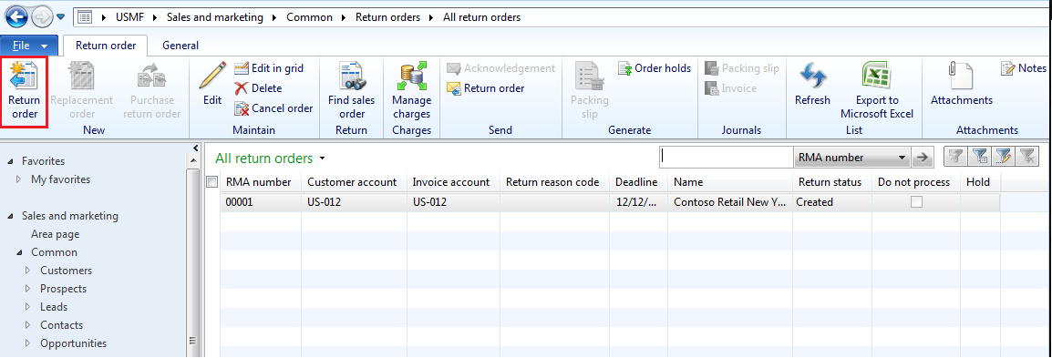

 5. Go to Sales and marketing --> Common --> Return orders--> All return orders
6. Click on Return order button (Marked red above) to create new return order.

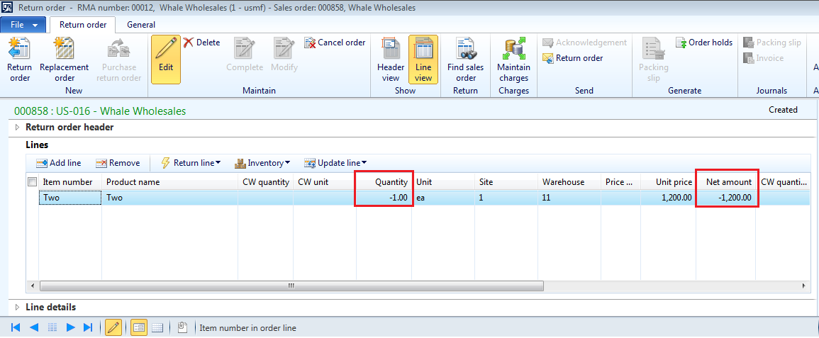

12. Click ok.
13. You can see a line will get created in the return order with negative quantity as we are going to receive item back.

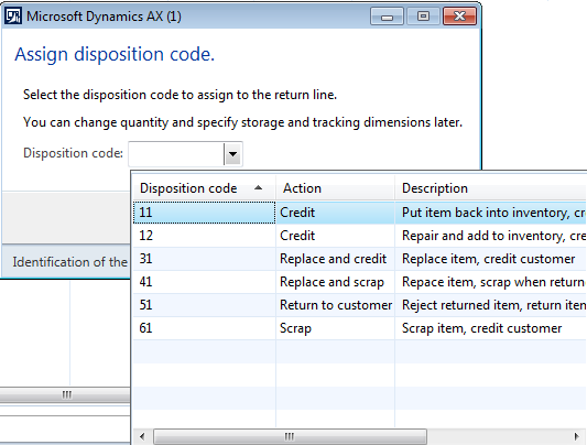

Registration:
17. In order to post the registration for the items which we are receiving, go to Update line--> Registration
Note:
Disposition code: We specify the codes in the system against the list of actions which we are going to perform with the inventory received and with the customers.
18. Enter the disposition code--> Click ok.

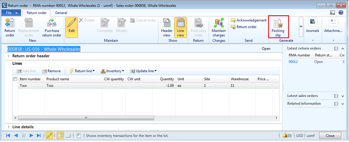

Packing slip:
26. Now the next step in the return order is to post the packing slip.
Note: Packing slip will get posted in the return order in order to register the financial impact of the received items in the system.
27. Click Ok to post the packing slip.

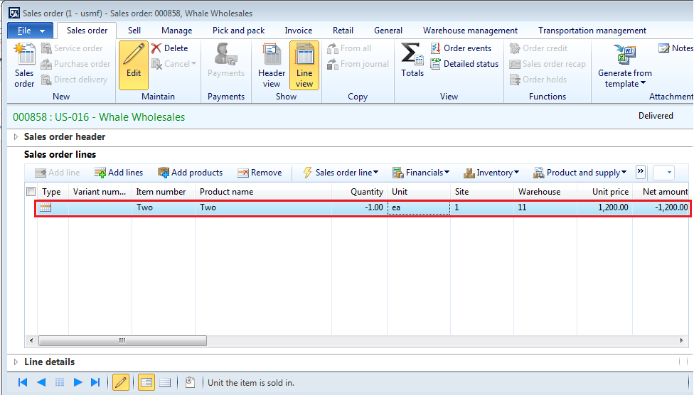

29. Go to Sales and marketing--> common--> Sales orders--> All sales orders.
Note: We can get the return sales order number from the return order form. Go to above path and filter by the return sales order number, we can see the sales order with the order type as "Returned order".(See below)
30. You can see order in Delivered state as packing slip is already posted for the return sales order from the return order form.

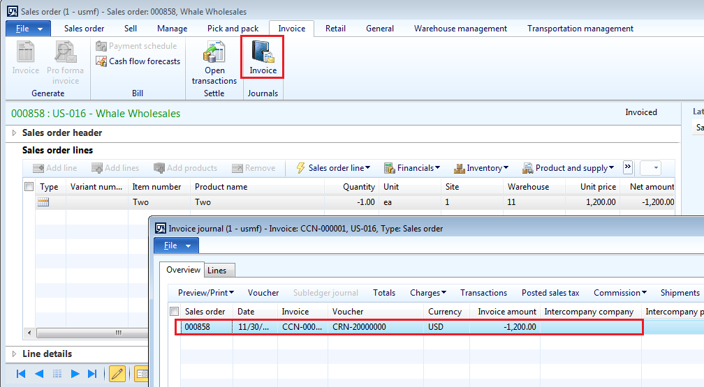

31. Select the order and click on Edit.
32. Go to the invoice tab--> click on Invoice button.
33. Click Ok to Post the invoice for the order.
34. You can see invoice journal is posted after the invoice posting.
Note: Once invoice is posted for the return sales order, the Return status for the return order changes to "Closed" state.
