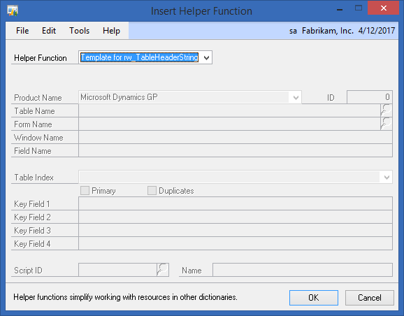

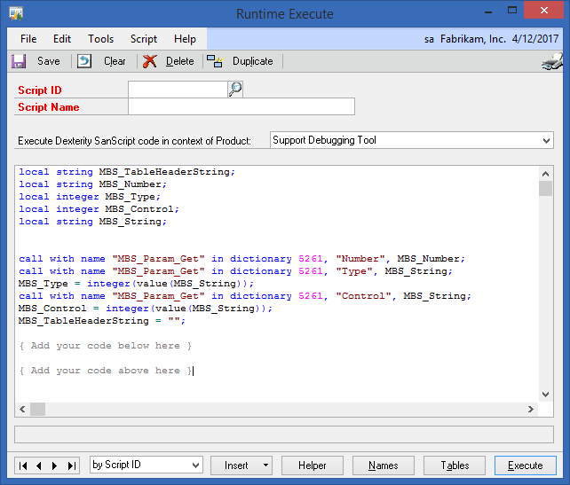

1. The first task at hand is to open the Runtime Execute window in the Support Debugging Tool. Once the window is open, click on the Helper button to open the Insert Helper Function window. From the drop-down list, select template for rw_TableHeaderString.
Below is the signature for the function as we will use it.
The rw_TableHeaderString function
We will use this function to return a string value for the selected Parent Customer ID information field to a Report Writer calculated field.
By clicking OK, the Support Debugging Tool inserts the code to get us started in the right direction.

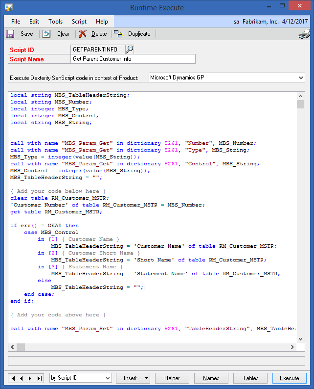

Very cool! All that's left now is to add the extra bits of code to retrieve the parent customer information from the RM Customer Master. In addition, we need to make sure that this code executes in the context of the Microsoft Dynamics GP product.
The template function even indicates where our code should be inserted and as you can see this is easy stuff for any entry level Dex developer. All we did here was use the MBS_Number local field as the parameter value that will contain our parent customer ID (to be passed from Report Writer) to get the piece of data we are interested in based on the value that we will supply to the MBS_Control local field (again, from Report Writer). The returned table value will then be stored in the MBS_TableHeaderString local field.
The Support Debugging Tool then goes to action and call its MBS_Param_Set API function to talk back to the Report Writer API script and deliver the values retrieved to it. Isn't this awesome!

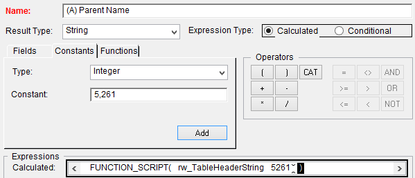

a) Create a new calculated field, in this case I will call it (A) Parent Name. The result type of the calculation will be a String and the expression type is Calculated.
b) Since we are using the rw_TableHeaderString user-defined function, we will choose this accordingly:
c) Now we have to setup the parameters as indicated by the function signature above. The first parameter we will add is the Support Debugging Tool's dictionary ID, 5261. We will add this as an integer constant.
d) Now we have to call the Runtime Execute script we created, GETPARENTINFO. We will add this as a string constant.

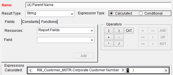

e) We now need to pass the parent customer number parameter, our default (not used) parameter, and the value number for the field that will be retrieved for the parent customer data, according to how we coded our script above. This is shown below.
The RM_Customer_MSTR.Corporate Customer Number field is retrieved from the RM Customer Master table which we created via a new table relationship and subsequently adding that table relationship to our report.

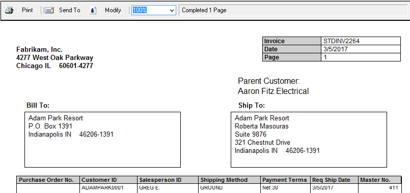

The following shows a muck-up of the report layout with the parent customer name calculated field created:
The report should display something like this when run in Microsoft Dynamics GP:
| Insert Helper Function window |
| Helper Code |
| Additional Code |
| rw_TableHeaderString |
| Dictionary constant 5261 to call the script we wrote |
| GETPARENTINFO |
| Last 3 parameters. |
| Report Layout |
| Invoice Layout |
