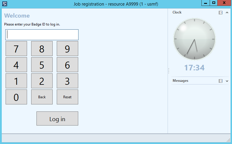

Now let's talk about what types of terminals you can use with out-of-the-box Microsoft Dynamics AX 2012. We have 2 main options: terminals embedded into Microsoft Dynamics AX 2012 itself and implemented as AX forms OR mobile terminals shipped as Windows 8 Apps
Shop Floor Terminals
In order to set up embedded terminals in Microsoft Dynamics AX 2012 you can use Terminals form available at Production control > Setup > Terminals > Terminals. You can use a classic laypout or touch optimized layout with bigger buttons
Terminal – Touch enabled
Please note Touch screen checkbox marked
Job registration screen – Touch enabled
Terminal – Classic
Job registration sceeen – Classic
You can also apply different configurations to registration forms if needed

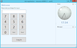

Job registration form - Production

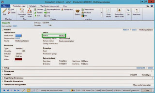

However before I start execution I'll also Start Production order. This is required because in current setup I have to start Production order before I can report it as finished. And my plan was to automatically report as finished Production order by completing its single production job on the terminal
Start Production order - Overview
Start Production order - General
Please note that I don't want to post the Route card in advance when I start Production order and instead I plan on recording the actual labor consumption associated with Production order based on what I record from the terminal. That's why I unmarked Post route card now checkbox and don't want to automatically consume route operations time
Infolog
Please note that from material consumption perspective I decided to post a picking list upfront when I just started Production order
Production order - Started
Now I can come back to the terminal (Job Registration form) and execute the job. For this purpose I'll select the job and press Start jobs button
Job Registration

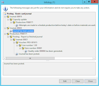

As the result Route card journal will be created and posted against Production order recording labor consumption from the terminal
Infolog
Because I completed a single job associated with Production order it gets updated to Reported as finished Status
Production order – Reported as finished

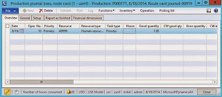

At this point we can also review Route card journal details
Route card journal
Please note that the system created 2 Route card journals. This is because in the first journal we reflect the fact Good quantity = 1 was posted and in the second journal we reflect the fact that 0.07 hours of labor was consumed. Please note that you may have numerous entries (journals) for hours if you start and stop the job multiple times before you complete it.
Route card journal – Lines (Journal 1)
Route card journal – Lines (Journal 2)

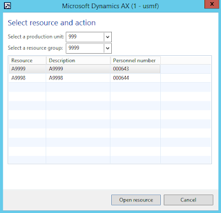

For these purposes you can use Change feedback screen. First I'll select a resource
Change feedback - Select resource and action

Now I want to reassign job to another worker/resource and I'll come back to Edit job list screen. First I'll select what resource I'm interested in, this is going to be original resource scheduled to execute the job

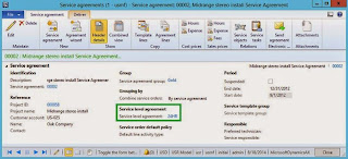

In Part 1 I highlighted how to do Service order activities manual Dispatch using Dispatch board. Now looking at Service management scenario from Manufacturing execution perspective we can say that Service order activities are not displayed (and not available) on terminals to act upon, however you can still manually record labor consumption associated with Service order by posting Service order.
Service order is associated with Project, that's why when you post Service order lines (say of type Hour) the corresponding Project journals (of type Hour for Hour-based Service order lines) will be created and posted which will bring corresponding labor consuption from Service order to Project.
Please note that Service management module also allows you to record and track time spent on Service order in order to ensure appropriate SLA (Service Level Agreement) level for the customer. For time recording I'd need a Service Level Agreement associated with Service order which is not the case with Service order I used in Part 1
Service order
So for this Service order I'll simply proceed with Service order lines posting to update a corresponding Project. For these purposes I'll first sign off Service order line in preparation for posting
Service order - Lines

When I successfully post Service order lines I'll see the following infolog
Infolog

For these purposes you will need to set up SLAs themselves first
Service level agreements
Then you can associate SLA to Service agreement
Service agreement
And when you create a new Service order based on Service agreement SLA settings will be propagated to the level of Service order automatically
