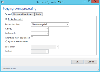

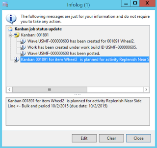

Then we can run Kanban pegging event routine to generate necessary kanban
Infolog

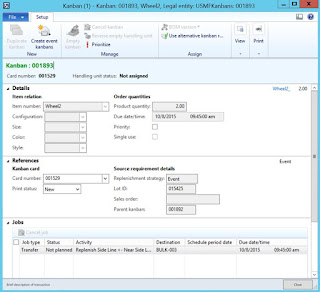

Please note that Manufacturing kanban has been generated to replenish Near Side Line location from Warehouse bulk location
Kanban rule
Kanban

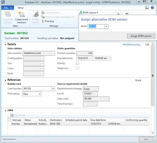

At this point we are missing BOM structure for kanban, so we are going to assign BOM version manually to kanban using Assign alternative BOM version function
Assign alternative BOM version - Before
Assign alternative BOM version - After

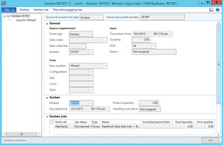

Now we'll look at kanban pegging tree
Kanban pegging tree

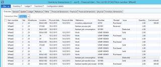

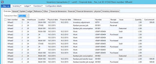

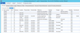

And also we'll take a look at inventory transactions
Inventory transactions

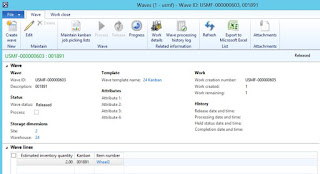

At this point we can also review Kanban wave
Kanban wave

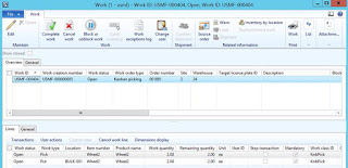

and generated Warehouse work
Work
Please note that wave would not be created and items would be picked if I had on-hand in BULK-001 for Wheel2

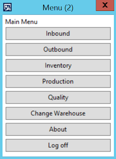

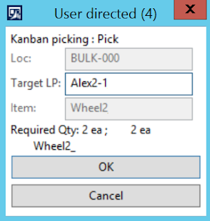

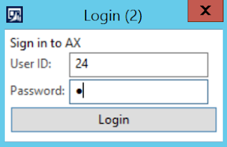

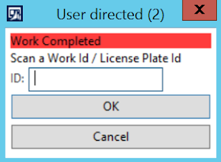

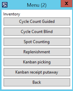

Now Warehouse worker will use hand-held device to execute Warehouse work
Login
Menu - Inventory
Menu – Inventory – Kanban picking

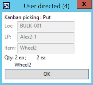

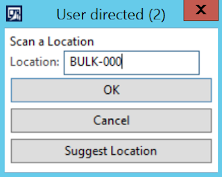

Kanban picking
Kanban picking
Kanban picking
Kanban picking
Kanban picking
Kanban picking work is now completed and we can take a look at inventory transactions

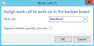

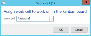

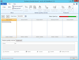

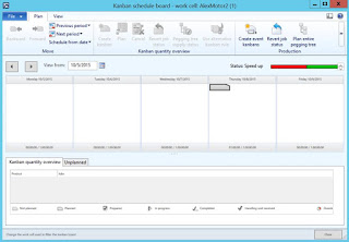

In a meantime we can also see Process kanban job planned on Schedule board and visible on Kanban board for Process jobs
Kanban board – Schedule board

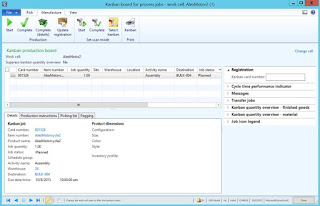

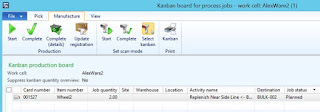

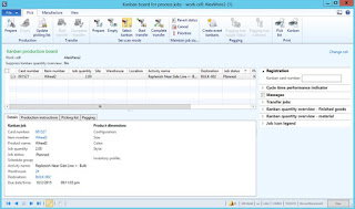

Kanban board - Process jobs

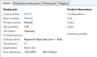

Kanban board - Process jobs (Details)
Kanban board - Process jobs (Picking list)

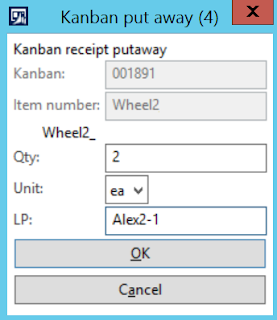

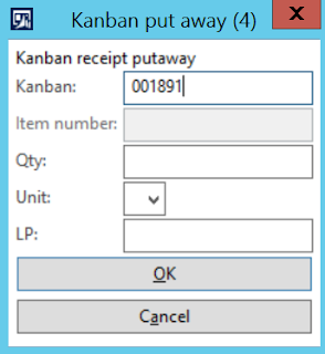

At this point we could complete kanban straight from Kanban board for process jobs, but instead of this we'll do kanban put away in WMS
Menu - Inventory
Kanban put away
Kanban put away
Kanban put away
Kanban put away

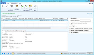

Also we can observe completed kanban on Kanban board for Process jobs

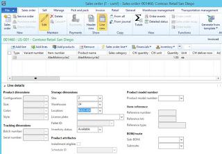

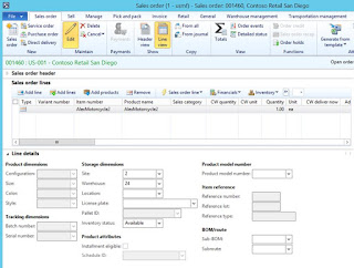

Next we'll place a new Sales order for AlexMotorcycle2
Sales order

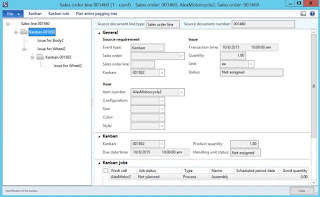

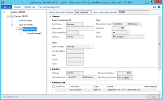

Please note that AlexMotorcycle2 finished product is expected to be in a Finished good location (BULK-004). After we save Sales order the system based on Kanban rules in place will automatically create necessary kanbans. We can review created kanbans by opening Pegging tree form
Pegging tree (Process kanban)
As you can see according to Kanban rules 2 Kanban jobs will have to be completed to produce AlexMotorcycle2, one for Transfer and another one for Process
Kanban (Process)
Pegging tree (Transfer kanban)
Kanban (Transfer)
This is how inventory transactions look like at this point
Inventory transactions (Wheel2)
Inventory transactions (Body2)
Inventory transactions (AlexMotorcycle2)

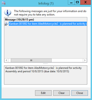

Now I'll plan the entire pegging tree
Plan pegging tree
Please note that Kanban Process job has been Planned, and no Kanban picking wave was generated
Pegging tree – Kanban jobs

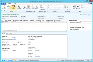

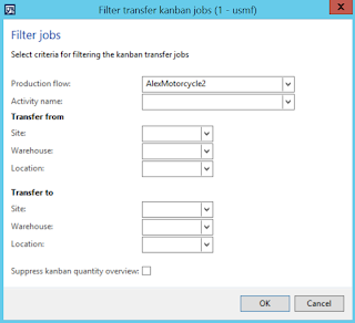

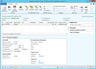

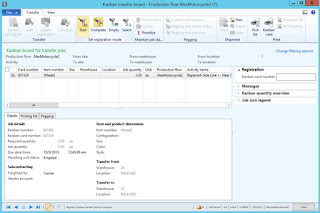

In a meantime we can review Transfer and Process jobs on Kanban board for Transfer jobs and Kanban board for Process jobs correspondingly
Kanban board for Transfer jobs - Details

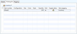

Kanban board for Transfer jobs – Picking list

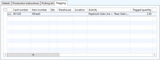

Kanban board for Transfer jobs - Pegging

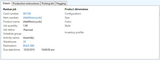

Kanban schedule board
Kanban board for Process jobs - Details

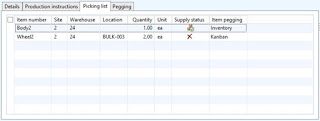

Kanban board for Process jobs – Picking list
Kanban board for Process jobs - Pegging

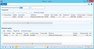

In case you want to do partial picking you can use Pick screen as presented below
Pick

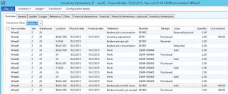

Here's how inventory transactions look like after this step

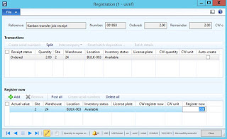

In case you want to do partial registration you can use Registration screen as presented below
Registration

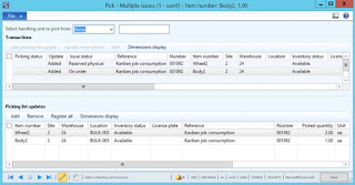

Pick
Pick
Please note that according to Storage dimension group I had to specify Locations on both lines

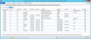

And again we'll take a look at inventory transactions

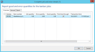

In case we need to complete partial quantity or specify Good/Error quantities you can use Complete job and error details screen as presented below
Process job – Complete with details
Process job

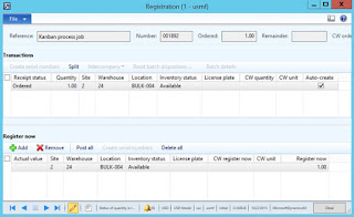

In case you need to update partial registration you can use Registration screen as presented below
Registration
Now we can take a look at inventory transactions again

And because we have produced the product we can now send it to the customer
Sales order – Packing slip and Invoice
Please note Location is specified on Sales order line per Storage dimension group requirement

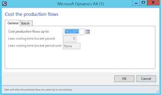

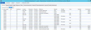

The very last step will be to run Lean costing routine to cost the production flow
Section: Costing
Cost the production flow
Prompt
Please note that no further registrations of kanban jobs will be possible after the date costing, but that's fine for the sake of this demo
