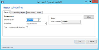

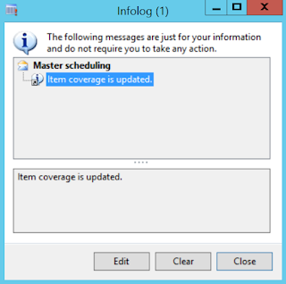

So instead of running Pegging events processing we'll run MRP this time for Wheel2 item to limit the scope of MRP execution
MRP
Infolog

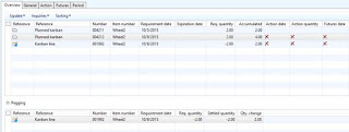

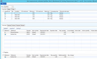

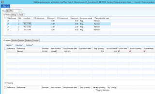

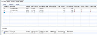

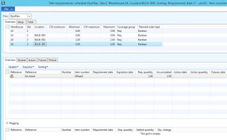

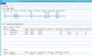

Now we'll look at Net requirements for Wheel2 item. There we can see how planned kanban has been generated to cover Minimum stock requirement for Wheel2 item
Net requirements
Net requirements (Side line location BULK-003)
Net requirements (Near Side line location BULK-002)
Net requirements (Near Side line location BULK-002) – Planned kanban 1
Net requirements (Near Side line location BULK-002) – Planned kanban 2
Net requirements (Warehouse location BULK-000)

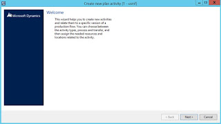

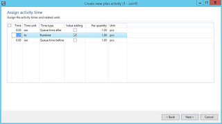

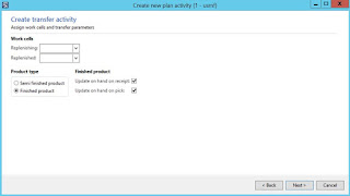

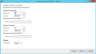

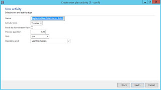

This is how we will create Kanban rule and appropriate Transfer activity for production flow
Production flow: Activity = Replenish Near Side Line <- Bulk 2 (Welcome)
Production flow: Activity = Replenish Near Side Line <- Bulk 2 (New activity)
Production flow: Activity = Replenish Near Side Line <- Bulk 2 (Create transfer activity)
Production flow: Activity = Replenish Near Side Line <- Bulk 2 (Assign transfer locations)
Production flow: Activity = Replenish Near Side Line <- Bulk 2 (Assign activity time)

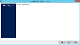

Production flow: Activity = Replenish Near Side Line <- Bulk 2 (Wizard completed)

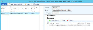

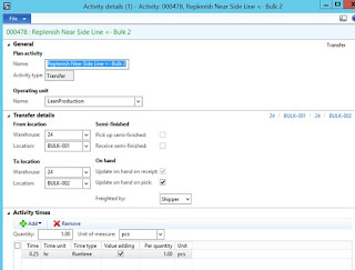

Now we'll take a look at newly created activity

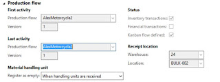

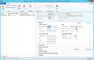

Then we'll create Withdrawal kanban rule as shown below
Kanban rule
Kanban rule - Events
Kanban rule – Production flow

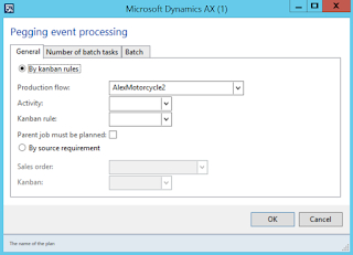

And then I'll execute Kanban pegging event processing routine

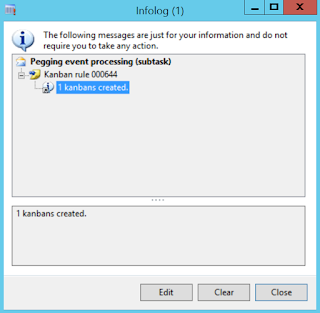

Infolog

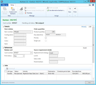

The following Withdrawal kanban has been created
Kanban
