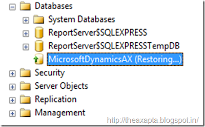

During one such operation, I have observed that the Database was struck in Restoring state. And no SQL operations were working on the DB with the usual error message: "The database is not accessible for the user" and "The database is currently in use".
