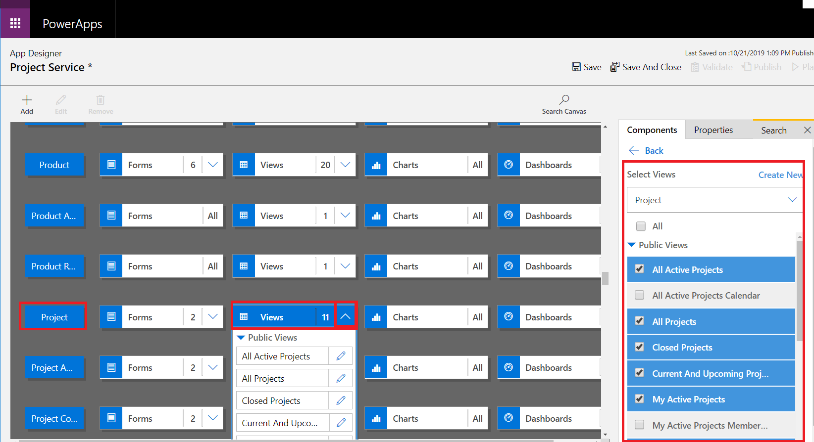

When the app designer opens, you can see all the entities that relate to the app, the forms that are accessible for each entity, views, charts and even dashboards. On the right side of the app (under artifacts) we can add or remove entities, dashboards and business process flows.
We can add or remove components for a specific entity by clicking on the chevron next to the component (I.E Forms, Views, Charts, etc.) of the entity we want to change. This will bring up the list of items that are available in the app. (I.E a list of account views or account forms) Lastly we can modify the sitemap by clicking the pencil on the right side of the sitemap.
In order to add the newly created project view to the app navigate down to the project entity, or type project in the search box. Click on the chevron next to the components (views) in order to see which views are included.
Find the view you want to add, then check the box next to the view to add it to the app. (You can add other components like forms and charts the same way) Click the save button on the top right, then click the Publish button. If you already had the app open before making these configuration changes, make sure you refresh your screen.
