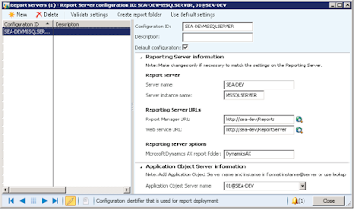

Open System administration > Setup > Business Intelligence > Reporting Services > Report servers.
To configure a report server, follow these steps.
1. Open System administration > Setup > Business intelligence > Reporting Services > Report servers.
2. Either click New to create a new report server, or select the desired
report server to modify. You can use the Use default settings button
to reset the Report Manager URL, Web service URL, andMicrosoft Dynamics AX report folder fields to their default entries.
3. Enter a name to identify the Reporting Services and AOS instances
that you are connecting in the Configuration ID field.
4. Enter a brief description to help you identify the Reporting Services
and AOS instances that you are connecting in the Description field.
5. Select the Default configuration check box if the Reporting
Services instance specified in this configuration is the default report
server for the AOS instance.
6. Enter the name of the server on which Reporting Services is
installed.
7. Enter the name of the Reporting Services instance.
8. Enter the URL of the Report Manager website. The default URL is
http://SSRSServerName/reports.
9. Enter the URL of the Reporting Services web service. The default
URL is http://SSRSServerName/reportserver.
10. Enter a name for the folder that will be created on the Report
Manager website in the Microsoft Dynamics AX report folderfield. If a folder does not exist, you can use the Create report folderbutton to create the folder.
11. Select an AOS instance.
12. When you are finished making changes, click Validate settings to
verify that the AOS instance can communicate with the Reporting
Services instance.
