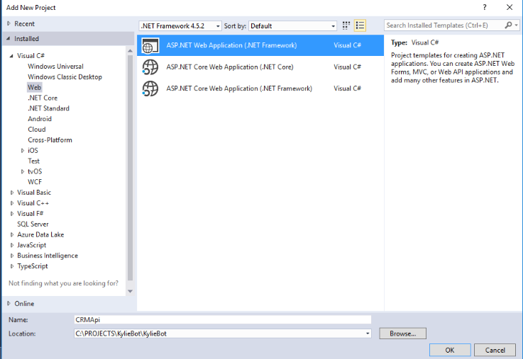

The first thing we need to do is add a new project to our KylieBot solution. To do this, right click on the solution and select 'Add->Project' like this:
You should then be presented with a project templates screen like this:

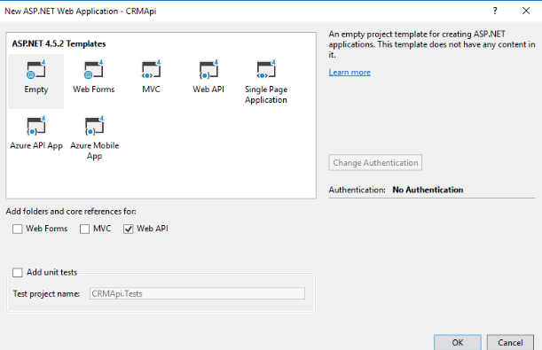

Make sure you have chosen the 'Web' item from the navigation tree on the left hand side of the screen. Enter in the Name field and then click 'OK'. You should then be presented with an Api configuration screen like this:

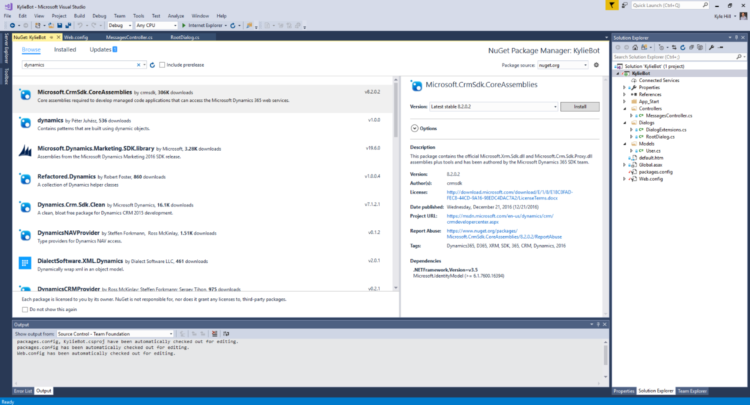

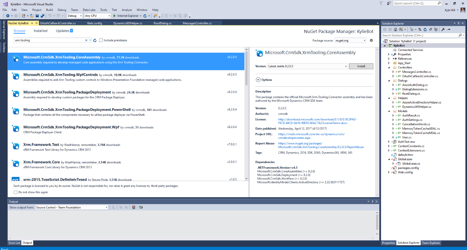

Make sure that you select the 'Empty' template and check the 'Web API' check box like the image above. Click 'OK' to complete the creation of the project. Next we are going to add 2 additional packages which will give us the required Dynamics 365 Customer Engagement SDKs that we will need in future posts. These packages are:
Microsoft.CrmSdk.CoreAssemblies
Microsoft.CrmSdk.XrmTooling.CoreAssembly

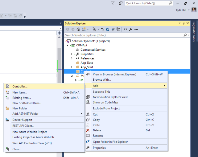

To add these packages, right click on the CRMApi project and select 'Manage Nuget Packages...'. Next, we need to add a controller to our project by right clicking on the Controllers folder in the CRMApi project and selecting 'Add->Controller' like this:

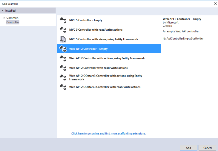

Next, select the type of controller we want, like in the below image:

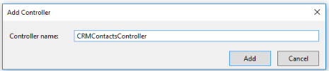

Make sure you select 'Web API 2 Controller - Empty' and then click on 'Add' in the bottom right of the screen to progress. You should now be presented with a screen where you can name you controller like this:
Update the name to 'CRMController' and the click 'Add' to complete the addition of the controller. Next, add the following code to the controller:

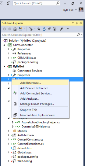

Next, let's add a reference in our main KylieBot project so that we can use some of the assets from the CRMApi project. To do this, right click on the 'references' item in the KylieBot project and select 'Add Reference' like this:

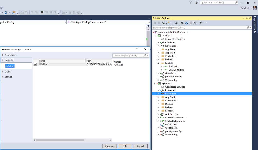

You should then be presented with this:

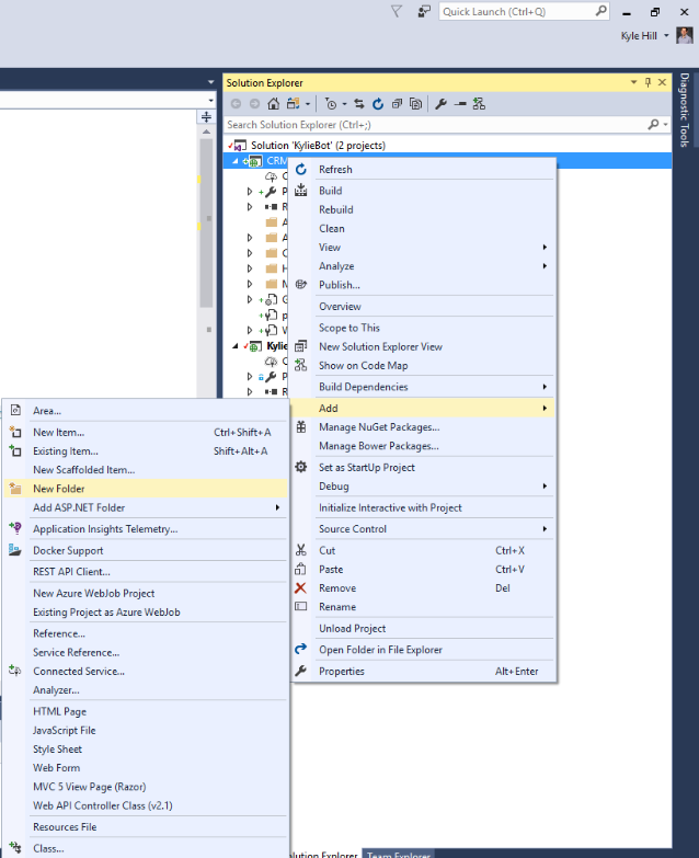

Next, check the checkbox next to the CRMApi project and click 'OK' to complete the addition of the reference. Next, we are going to add a Helpers folder to our CRMApi project by right clicking on the project and selecting 'Add->New Folder' like this:

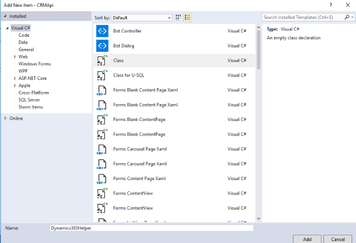

Next, rename the folder to 'Helpers' and add a Dynamics365Helper class like this:
You can also go ahead and add the following code to the Dynamics365Helper class you just created:

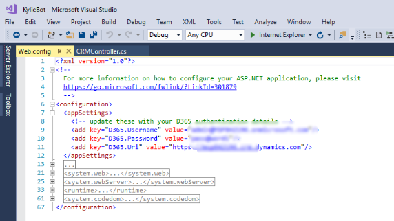

Finally, lets add some configuration lines to the web.config file of our CRMApi project like this:
