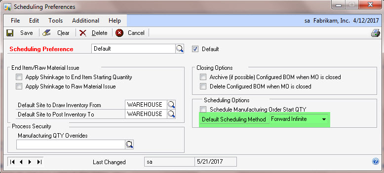

In Manufacturing Setup, in the Scheduling Preferences window, one of the choices you need to make is whether to use Forward or Backward Infinite to schedule your manufacuring orders.
Manufacturing>Setup>MO Schedule Preferences
* click image to enlarge
What's the difference between the two methods?  Forward Infinite uses an order release date that you provide and schedules MO activity forward from that date.  Backward Infinite uses an MO due date that you provide and schedules MO activity and the planned MO release date backward from the due date.  The Infinite part of the setting means GP assumes your capacity resources are infinite as opposed to finite.  In a finite environment, the system would take into account resource constraints when planning MOs.
