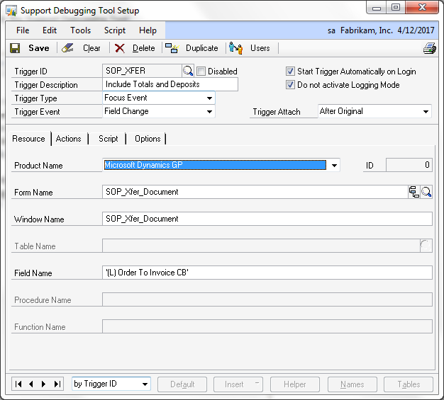

The first thing we need to do is setup the trigger itself. In this case, we want to select a Focus Event trigger that will fire exactly on a field change condition. The field in question is the '(L) Order To Invoice CB' checkbox field. You can use the lookup button next to the Form Name field on the Resource tab to open the Support Debugging Tool's Resource Explorer window and locate the field and select it.
Trigger Setup

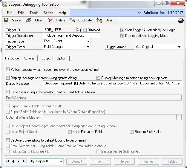

Since this will be a non-logging trigger, we will want to check the Do not activate Logging Mode option on the window. And to make sure the trigger always starts up with Microsoft Dynamics GP, we will want to check the Start Trigger Automatically on Login option as well.
Second, we can choose to have the Support Debugging Tool perform certain actions when the event fires - the event being when the checkbox is marked. If you happen to be running build 15 of the SDT, you can have a message display as a desktop alert on the lower right corner of your screen, similar to when you receive a Microsoft Outlook message.
For the purpose of this trigger, we will not take any actions when the trigger fires.

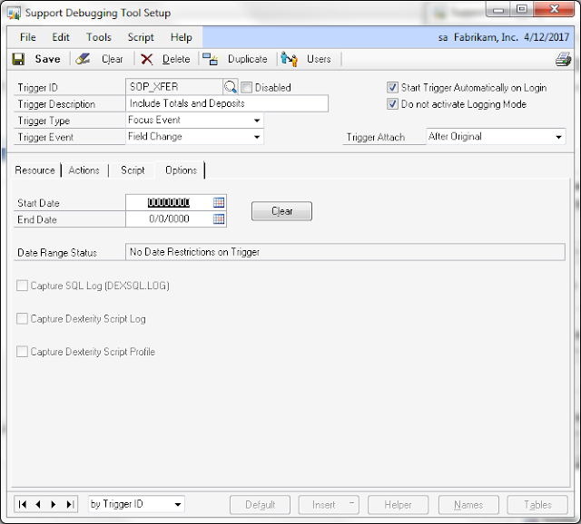

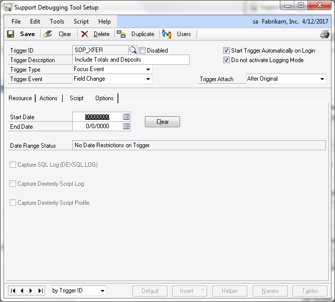

Finally, since this is a non-logging trigger, the Options tab will show all logging options disabled. However, you can still choose a date range for this trigger to take effect.
Options tab
Since the goal is to have this trigger available at all times, there's no need to add a start and end date. It's now time to save the trigger and enable it.

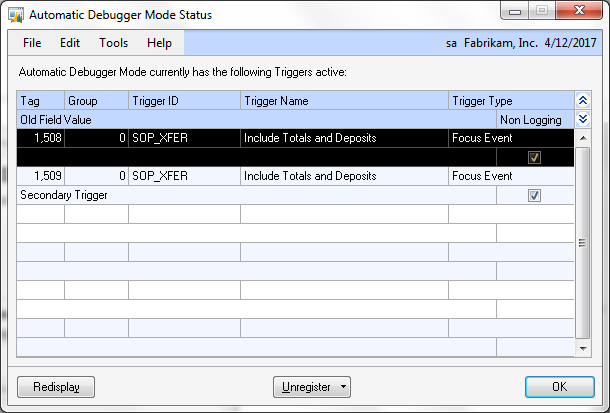

We can choose to turn on our Non Logging Automatic Start Only triggers. Since our SOP_XFER trigger has been marked as a non-logging automatic trigger we should be able to see it in the Automatic Debugger Mode Status window.
