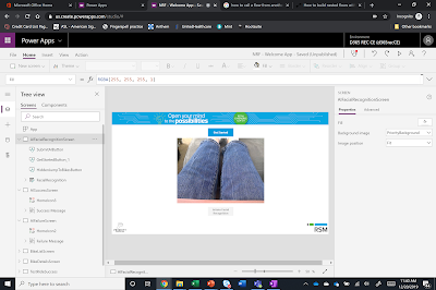

The initial page of this app is much more simple by design. It is similar to the sign in app in that it contains the same camera and image controls. However the camera control and image control are much larger because I don't need to take up real estate for the contact information. (After all, I theoretically already know who you are because you signed up in the sign up app at the booth or on the bus.) [Also it does not do leg or feet recognition - HA!]
The first page of the app is quite simple to look at. You click a get started button to take the picture. Then you click the Initiate Facial Recognition button to kick off the whole thing. The camera and image controls again, are the same size and overlap each other. You can learn more about these controls in the first part of this blog series.
Where the magic really happens is in the OnSelect of the Initiate Facial Recognition Button. I wish I could make the button play audio in the Start Trek/Sci-Fi voice, because that would make this even more often.

Here is the actual function in the OnSelect button property:
Set(gloresult,'NRF-Sign-In-AI-Facial-Recognition'.Run("PowerAppImage",ImagePreview));
Set(
    gloNextScreen,
    If(
        gloresult.ismatch,
        AISuccessScreen,
        AIFailureScreen)
Set(
    gloResultContact,
    First(Search(Contacts, gloresult.name, "fullname"))
Set(
    gloResultCategory,
    gloResultContact.'Bike category preference'
Set(
gloResultContactName,
gloResultContact.'Full Name'
Navigate(
gloNextScreen,
ScreenTransition.Fade

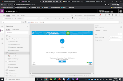

The AI Success Screen is also very simple. It simply displays the persons name and the category of bikes they selected from the first app. The next button navigates to a new screen where they can start to explore the bikes. I will explore this screen and the amazing IoT magic that is happening there in my next blog.
The failure screen is also very simple. This could use a bit more design work to make an experience to recapture their data if we could not find them, but again for simplicity sake we just say sorry we could not find you. Keep in mind that facial recognition is not perfect. Although we have done some testing with different lighting, faces, beards, glasses, hats, and so on - it is by no means perfect. One thing to note is that the images you capture for facial recognition really need to be a close up with just a face. It cannot be a full body shot or have multiple people in the image. We also found that the Surface Hub 2S camera requires you to get awkwardly close to get a good enough image for the API to recognize you. So we are actually casting a Surface Pro tablet to the Hub and the image is captured with the tablet.
