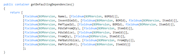

Default values are only set for the fields that have dependencies, which are defined in the method getDefaultingDependencies. It has a "predefined" structure and one field can have multiple dependencies.
The structure is a container with containers for every field that needs defaulting and a container inside every of those containers for dependencies. Multiple dependencies are separate elements (field ids) in a dependency container. If you duplicate fields that needs defaulting, only the first one is picked up.

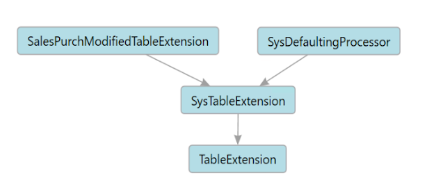

The most common implementation is SysTableExtension. There are a couple other implementations that extend it. It is SysDefaultingProcessor and SalesPurchModifiedTableExtension.
If you have a look at SysTableExtension you can find out that first it collects field dependencies from the table method getDefaultingDependencies and later calls defaultField for every field that has a dependency.

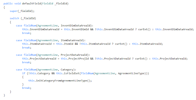

public void defaultField(FieldId _fieldId)
super(_fieldId);
switch (_fieldId)
case fieldNum(TestDefaultingFields, Total):
this.Total = this.Qty * this.Price;
break;

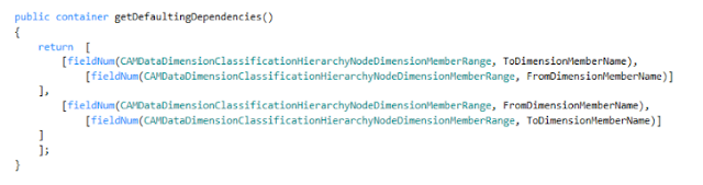

Cyclic dependencies
You can also define cyclic dependencies where one field can be dependent on the other and vice versa at the same time.Have a look at CAMDataDimensionClassificationHierarchyNodeDimensionMemberRange table.
Don't worry, the system will not break :). Defaulting logic collect dependencies using Breadth First Search (BFS) to traverse dependency graph.
