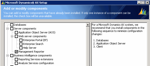

Run AXSetup and choose to install "Management Reporter"

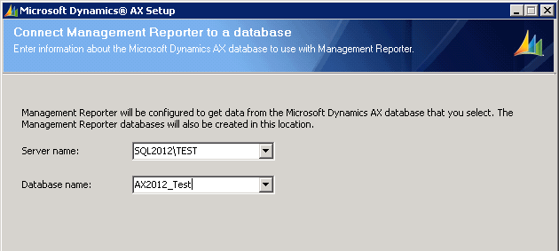

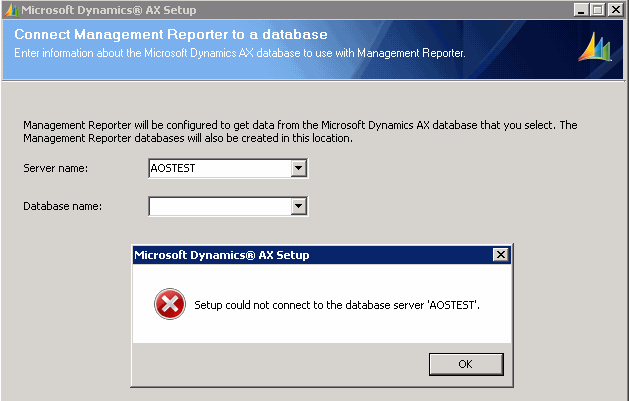

Select the SQL Server Instance and Database holding the business data. In my example setup threw an error before I was able to select an actual server running a SQL Server Instance. Maybe they'll fix that in some update.

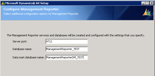

Type in some additional details for the Management Reporter Service. Default port is 4712. The first database entry points to the configuration database. The second to the data mart database, which will hold report data. I just added a suffix so I can test installing multiple instances later on.

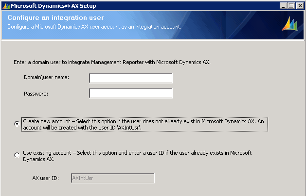

Finally type in the credentials for the domain user which will be used to connect to AX and collect data. Either let the installer set it up or choose an existing AX User ID.

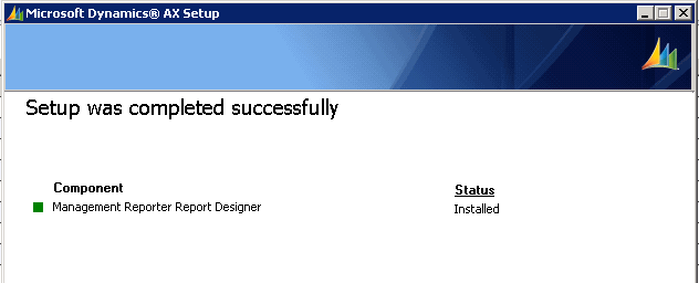

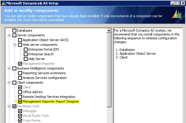

Run AXSetup and chose to install "Management Reporter Report Designer". This will install both the Designer and the Viewer. You can install these on the terminal server if that fits your requirements.
Done!

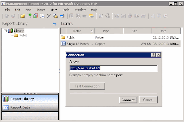

First, let's test the Designer. Locate the shortcut "Report Designer" under the Start menu.

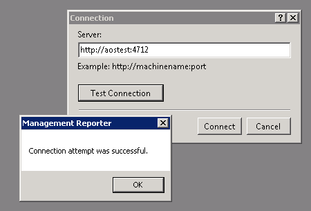

Enter the url to the server and port where the Management Reporter is running and connect. This is a one time per user per machine thing (as far as I know).

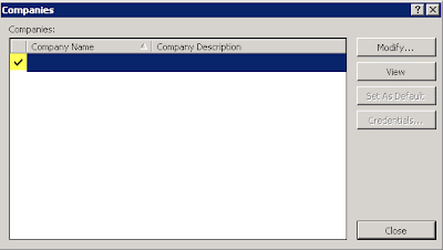

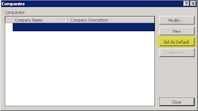

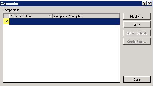

Select a company and hit the "Set As Default".

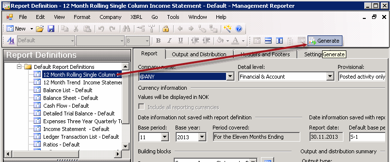

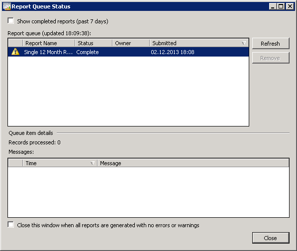

Select the first report and hit "Generate" on the toolbar.

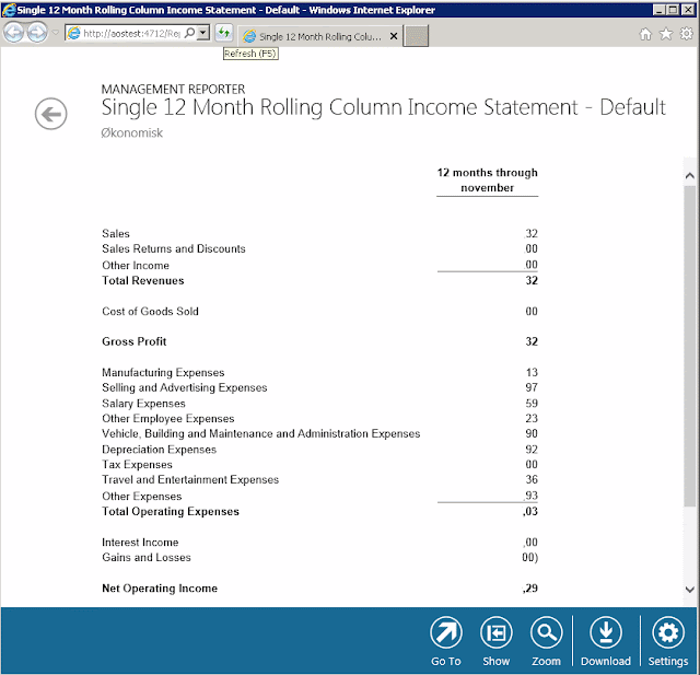

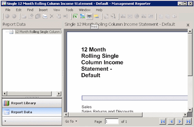

Observe while the report is generated. Let it complete and wait for the report to be launched in a new window.
And the report should open. Yea, I hid some of the numbers from my demo.
