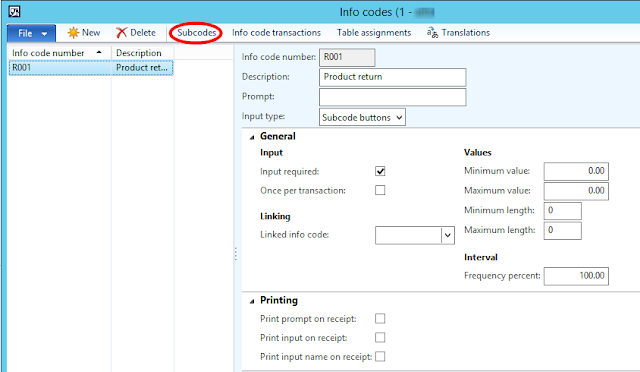

Retail>>Setup>>Info Codes
1. Enter an Info code number, Description, Prompt (if desired) and the Input type.  In this case, we're using Subcode buttons as the Input type as we wanted the code to be entered via button selection
2. In the General fast tab, select 'Input required' and set the 'Frequency percent' to 100.00
3. Click on the Subcodes button
4. In the Subcodes form, enter the Subcode number (or text), the Description, Trigger function, Trigger code, and Price type.  If you wish to use a Return price different from the original product price, enter that price or a % off list in the Amount/percent field.
Note: You can nest multiple Info codes in Info code groups (Retail>>Setup>>Info code groups) if desired.  For this example we'll not use this feature.
5. Close the Subcodes and Info codes forms

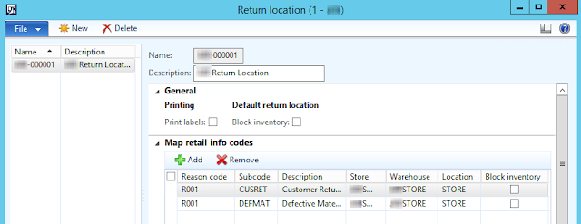

Go Retail>>Setup>>Return locations
This is where we cross reference the Info codes we just created to the store(s) Return location(s).
1. Enter a Name and Description
2. Select 'Print labels' if you want to print Return labels
3. Select 'Block inventory' if you want the returned items to be blocked from use in other transactions
4. Click the 'Add' button in the 'Map retail info codes' fast tab to map these codes to your store(s)
5. Select the Reason code, Subcode(s), Store, Warehouse and Location.  You can also set the 'Block inventory' selectively here by store and/or Subcode
6. Close the 'Return location' form
Now, run the '1030 - Info code information' Distribution schedule under Retail>>Periodic>>Data distribution>>Distribution schedule to push the changes out to the retail channels.

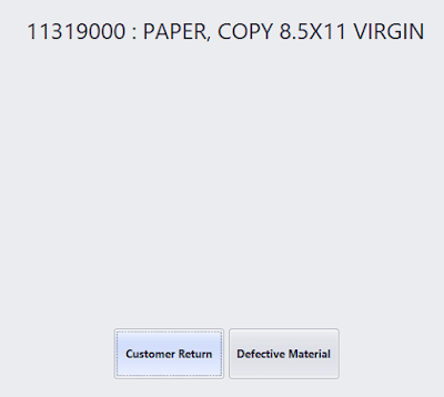

Enter a return transaction at your POS register.  After selecting the product to return, the following prompt appears. Select the appropriate code to continue.
Once completed, return transactions are saved with the Info code, allowing you to analyze POS returns by Info code to determine what is driving returns at the store level and throughout your retail operation overall.
