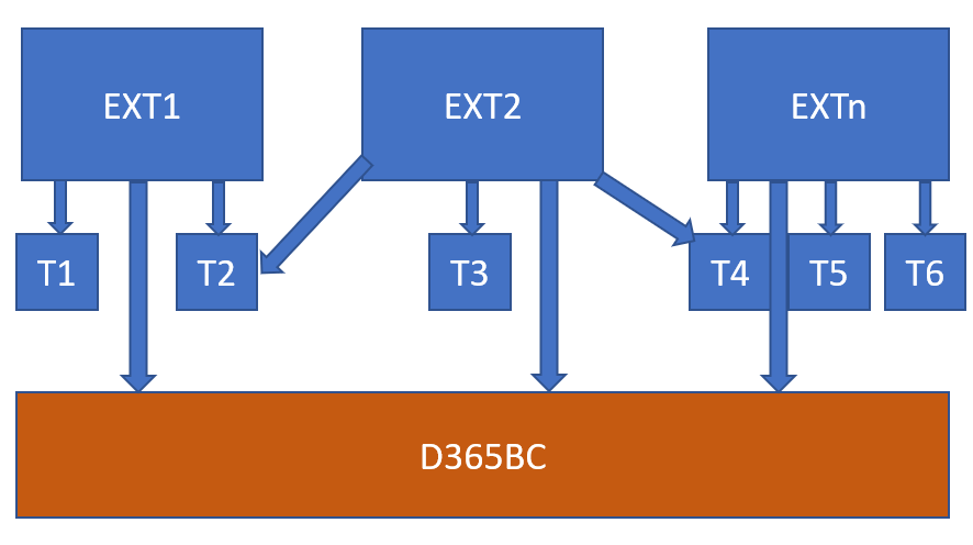

If you choose to go for the “N separated extensions” road, remember that:
  • An extension cannot see objects from another extension.
  • If extension 2 needs to see objects of extension 1, it must be dependent from 1.
  • You need to carefully handle dependencies between the different Dynamics 365 Business Central extensions.
My suggestion here is: don’t abuse on splitting (for example, a single extension for every minimal existing functionality) and do not afraid to use dependencies only because they bring complexity in your development process.

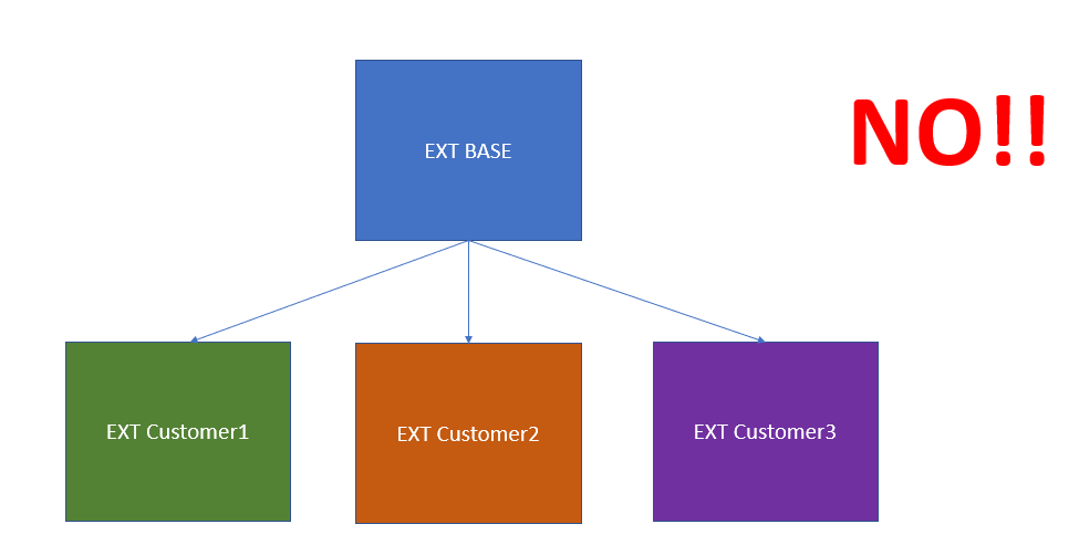

Rule 3: do not fork the base code

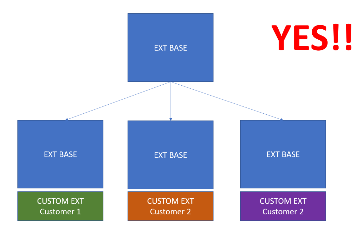

The extension model has a great advantage over C/AL: it permits us to create customizations on top of a standard layer. This is a rule that you must always follow on your solutions, especially when you customize your solutions for specific customers.
One of the errors I see on some partners is that they continue to have a “C/AL-like” approach to customizations of their products. If you have released a solution as an extension (and this is your base solution) and N customers asks you to have specific customizations for your solution, please don’t create N “copies” of your base solution and modify them for every customer:
What you should do is to create the customizations as a specific per tenant extensions that will be dependent from your base extension:
This will permit you to have ONLY ONE SINGLE BASE CODE (a must in the extension’s world).

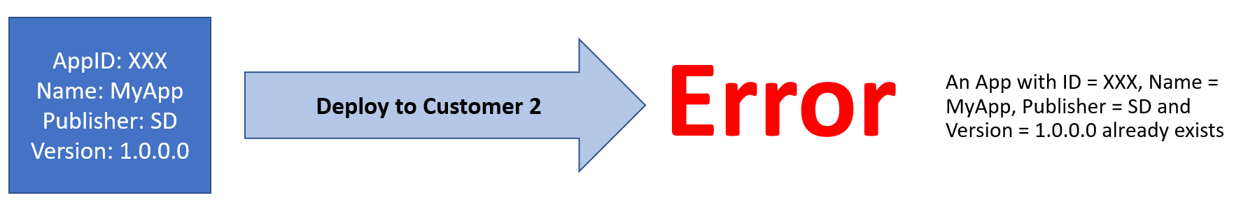

Many partners think that per-tenant extensions are more easy for starting (no validation process, you can manage all by yourself), but per-tenant extensions also have their (big!) problems due to their internal processing by the Dynamics 365 Business Central engine. In particular, what normally happens with PTEs on every partner I see is the following:
They release an application X as a PTE to Customer 1: all is ok
Then Customer 2 wants the same application (PTE X), they compile the project (check if all is ok, etc) and they deploy the extension to Customer 2:
Unfortunately, the same PTE extension can be uploaded to different tenants only under certain conditions:
  • If the Dynamics 365 Business Central regional service is different for customer 1 and 2
  • If the Dynamics 365 Business Central regional service is the same for customer 1 and 2 then the following 3 conditions (in OR) must be respected:
    • only if Package ID is the same;
    • only if AppID or Version is different;
    • only if Name, Publisher and Version are different.

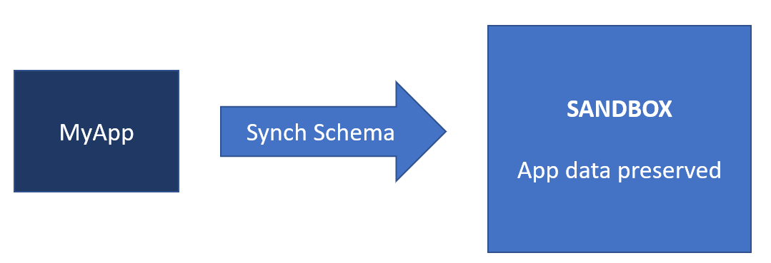

Unfortunately, during the development phase of an extension is quite common to “correct mistakes” and have the needs to “force” schema changes. If you deploy with “schemaUpdateMode”: “Recreate”
all your data will be lost:

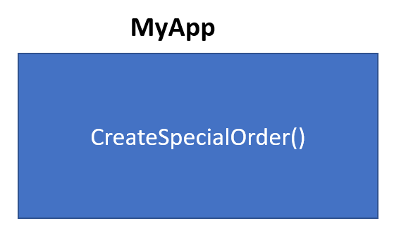

Rule 8: Use events if you want to be extendible
This is another common error I see quite often. When a partner moves its C/AL-based solution to AL, it doesn’t think on the extensibility of the solution (extensibility for other partners that uses the solution or for the author itself).
To be more clear, consider an extension that adds a new function (feature) called CreateSpecialOrder to Dynamics 365 Business Central:
Without exposing events:
  • you can modify the behavior of the solution for a customer only by modifying the base app itself;
  • another partner that uses your solution cannot modify the standard behavior.
When you create Dynamics 365 Business Central extensions, remember to add events (Integration events) to your extensions in order to permit extensibility. In the example, you could have something like this:
Here another extension can subscribe to the events and make some actions or change the standard behavior of the CreateSpecialOrder method. This is a pattern that you have to remember always, or your solution will not be customizable.

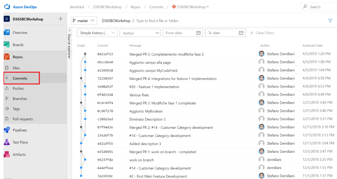

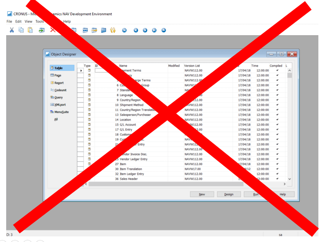

Rule 9: Handle source control
This is a problem that you will have starting from the first day of developing extensions in the team.
Now, all the “components” of your development environment are no more on a single box:
With NAV you have The C/SIDE and all your objects are stored on the database itself. If you work on a team, when you access an object on C/SIDE, you can immediately see the modifications that other colleagues have done on that object.
AL development is different, and you have:
–    docker-based environments that can be different for every developer;
–    Visual Studio Code (on the developer machine);
–    AL project files and folders (stored on the developer machine).
Source code is now external (file-based), and you absolutely need a central repository for your code and a source code management tool for handling merging and conflicts. Start being confident with GIT and embrace tools like GitHub or Azure DevOps (my personal favorite tool) for handling your projects:
This can save you time and efforts.

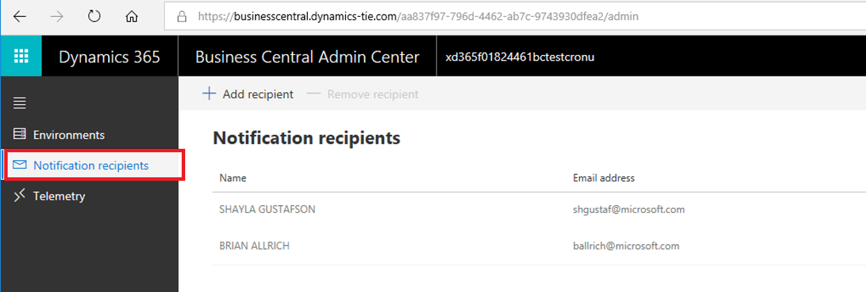

Rule 10: remember the notification recipients in the Admin Center
This is another point to remember. Dynamics 365 Business Central has an Admin Center where you can administer some aspects of your tenant (like creating sandboxes, managing upgrade windows, checking the telemetry, etc.).
One of the key points here is the Notification recipients panel:
Please always insert the email address of the users (administrators) here, that should receive notification from Microsoft about this tenant. This is the only way for being notified about problems on your tenant (like upgrades or extensions that doesn’t work with a new tenant upgrade like described here.
