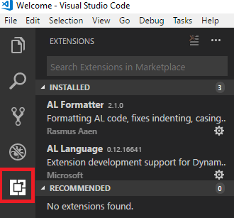

  2. Install VSIX Extension for VS Code

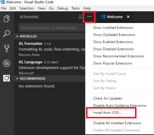

2.1. Click on Extension button at the Left corner of VS code
2.2 Click on the more button ( three dots) and select Install from VSIX. Navigate to the path  “CU 02 NAV 2018 NA\NAV.11.0.20348.NA.DVD\ModernDev\program files\Microsoft Dynamics NAV\110\Modern Development Environment” to install VSIX
