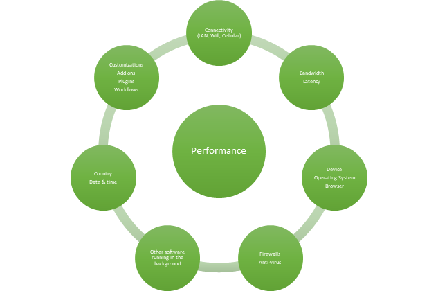

How a system performs is based on several key items. The majority of the time, users put ‘slowness’ down to what’s right in front of them which is Dynamics 365 CRM. And then helpdesk/consultants/developers dive straight into Dynamics 365 CRM or the Power Platform to find the cause. This might be causing you to waste time and energy.
Let’s have a look at the things that make a system perform.
To get optimal performance, you need to have all the above items working as one without running into each other. When you get one or more items misbehaving, you’ll start seeing poor performance.
So, a tip for everyone, before you go straight into troubleshooting the power platform,Dynamics 365 CRM customizations, add-ons, plugins & workflows; you should capture information about things such as firewalls, anti-virus software, browser information, bandwidth, latency, day and time of day, what type of connection the user is using etc. This’ll help you to swiftly resolve any ‘slowness’ issues and also provide better responses to your users.
