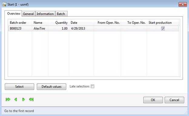

The next step in Car tire (AlexTire) batch order life cycle is to start batch order
Batch order: AlexTire – Start

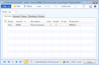

Picking list journal is used to post material consumption
Batch order: AlexTire – Picking list journal
Picking list journal header references Batch order for Car tire (AlexTire)
Picking list journal lines have details of what ingredients have been picked for Car tire (AlexTire) production

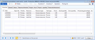

Route card journal is used to post labor consumption
Batch order: AlexTire – Route card journal
Route card journal header references Batch order for Car tire (AlexTire)
Route card journal lines have details of what operations have been performed for Car tire (AlexTire) production

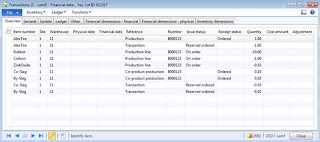

At this moment the system physically updated issue inventory transactions for Car tire (AlexTire) Formula ingredients. By other words ingredients for Car tire (AlexTire) have been used in production process
Inventory transactions
Please note that issue inventory transactions for Car tire (AlexTire) Formula ingredients changed their statuses to Deducted

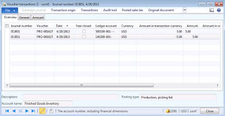

*Voucher transactions
Ledger voucher provides details on which account was credited for “Production, picking list”, which account was debited for “Production offset picking list” as well as on additional postings happened because of material overhead applied

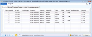

*Route transactions
Route transactions show the details of labor consumption postings for Process jobs (37.50$)

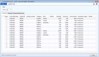

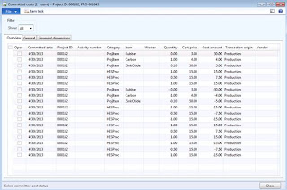

At this point you can review Project committed costs related to consumed material and labor
Project – Committed costs
Please note that the system reversed project committed costs for material and labor after material and labor have been actually consumed in production process. The only open committed cost transaction left is for labor Process job because the job itself is not yet Ended

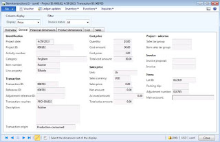

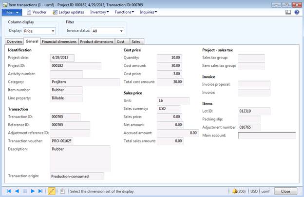

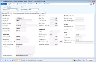

Project item transaction – Rubber (General)
Project item transaction – Rubber (Cost)
Please note that cost price for Rubber is 30$ which corresponds to cost of ingredient (!)
Project item transaction – Rubber (Sales) (!)
Project item transaction – Rubber (Voucher)
Ledger voucher provides details on which account was credited for “Production, picking list” and which account was debited for “Project – cost”
Project item transaction – Rubber (Ledger updates)

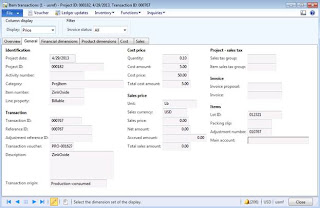

Project item transaction – Carbon (General)
Project item transaction – Carbon (Cost)
Please note that cost price for Carbon is 4$ which corresponds to cost of ingredient (!)
Project item transaction – Carbon (Sales) (!)
Project item transaction – Carbon (Voucher)
Project item transaction – Carbon (Ledger updates)

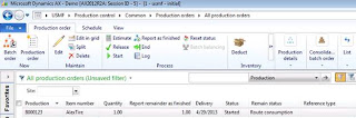

Once you reported batch order as finished you can see the list of Production orders on Production orders list page
Production orders
Report as finished journal is used to record finished good receipt as well as co/by product receipts into inventory

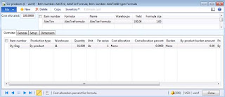

Report as finished (By-product)
*Inventory transactions
Inventory receipt transactions for By-Slag by-product will be displayed on Voucher transactions screen for Report as finished
<![if !vml]> <![endif]>

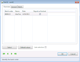

The next step in Tire (AlexTire) batch order life cycle is to end batch order
Batch order: AlexTire – End
Once you ended batch order you can see the list of batch orders on Production orders list page
Production orders

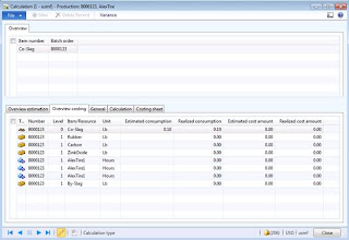

From costing perspective after ending batch order the system calculated actual cost of batch order based on actual material and labor consumption
Batch order: AlexTire – Price calculation
Please note that the system segregates consumption of materials from consumption of labor on Overview costing tab. Our Costing sheet is empty that’s why we don’t have Costing sheet details
However on Costing sheet tab you can also see an aggregated Total as well as breakdown based on Cost groups defined in Costing sheet
Ledger voucher provides details on which account was credited for “Production issue” and which account was debited for “Production offset account issue”. Similarly which account was credited for “Production offset account receipt” and which account was debited for “Production receipt”.  Cost adjustment is reflected in “Production substitution variance” posting.
You can still do extended project cost control analysis using Cost control screen
Project – Cost control
Since the time when project item and hour transactions have been posted against the project, they are ready to be included into Project invoice proposal in order to invoice the customer
Project transactions

Appendix B: By-products
Please see different scenarios for burden cost for by-products described below. For the sake of clarity in these scenarios only by-product (and no co-product) is the secondary outcome for production process.
Scenarios

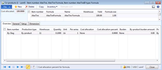

<![if !supportLists]>1.       <![endif]>Burden = None
In this scenario the system doesn’t add burden cost related to by-products to total production cost
Formula: AlexTire – Co-Products
Please note that Burden = None for By-Slag by-product. This means that the system will not add burden cost related to By-Slag by-product to total production cost

When you End the batch order the burden value is calculated automatically and posted in Route card journal adding to the cost of the batch order
Production order: AlexTire – Route card journal
Route card journal lines have details of burden cost applied for Car tire (AlexTire) production
Inventory receipt transaction for Car tire (AlexTire) will be displayed on Voucher transactions screen for route consumption
Ledger voucher provides details on which account was credited for “Production WIP issue”, which account was debited for “Production - WIP” because of burden applied

*Route transactions
Route transactions show the details of burden posting (38.25$)
